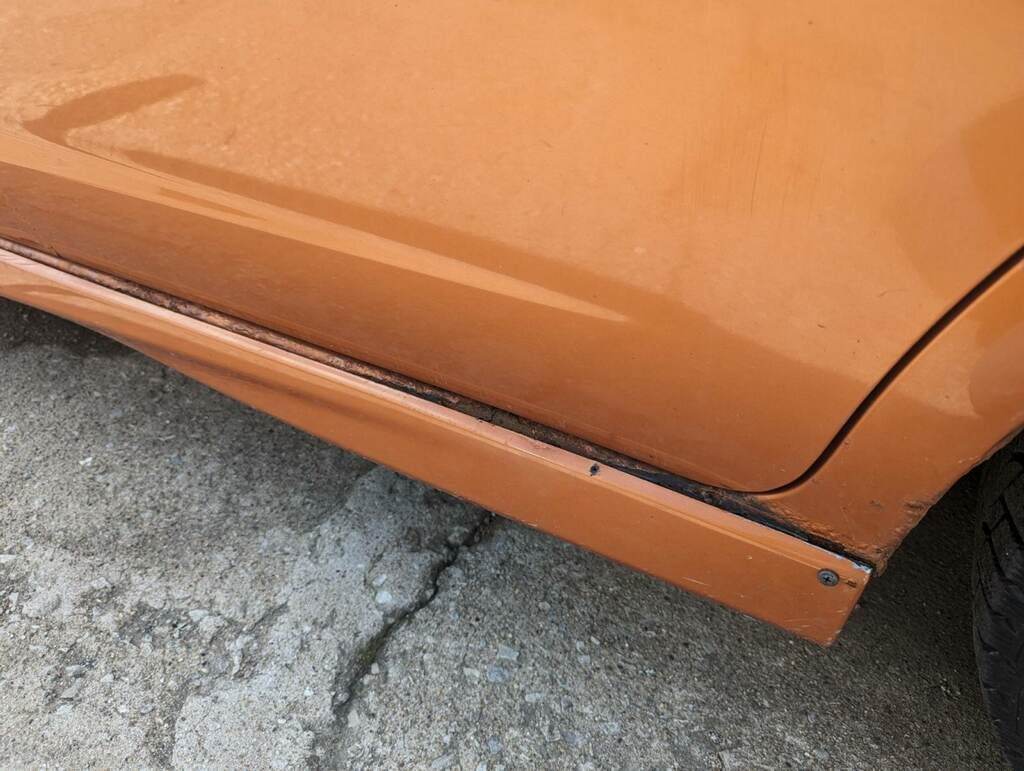

It's a 2009 Fit Sport, 172,544 miles, $4000 (Carfax says it's worth $5950). It's older with more miles than I've been hoping for, but my budget is *really tight*.
The Carfax report is eleven pages long (this car has had more regular maintenance than I ever put into a car!). Five previous owners, including the dealerships that sold it. I've already talked to my mechanic about taking a look at it. He balked at 172K miles for any car, insisted that he'd give me the straight dope about its condition. Hey, I want him to give me an honest assessment.
And it's ORANGE!!! (the color I've been dreaming of in a Fit).
Update: the dealership sent me pictures of the rust on this car.... :-( At least they're being honest about it. Adding those pictures in a comment below.

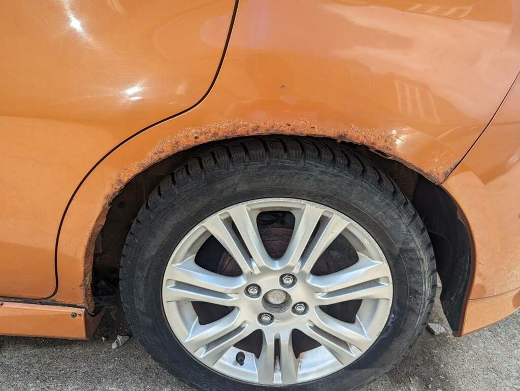

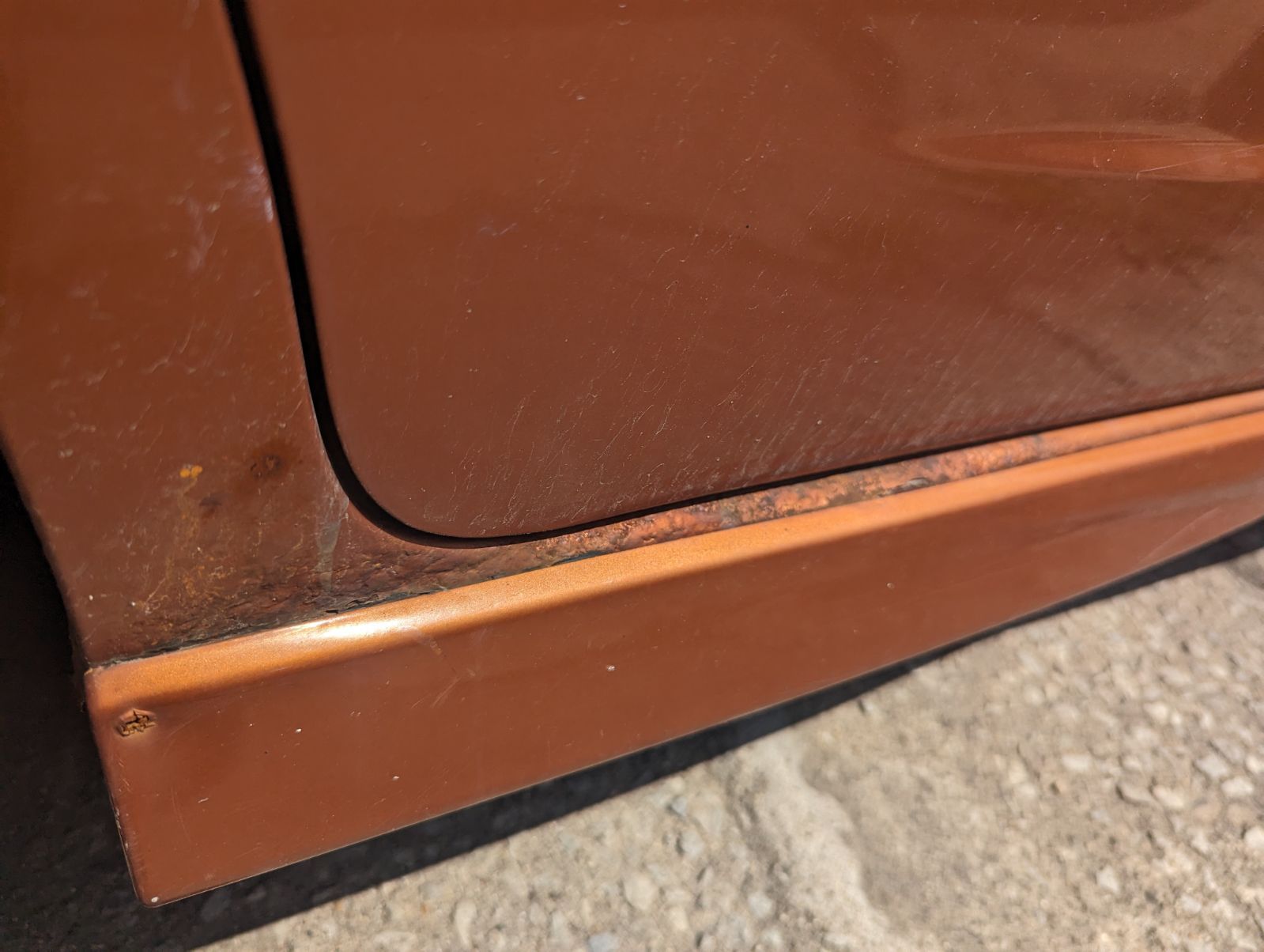

Photos of rust. The underside looks like an ancient Roman ruin...

Am I correct that's a frame rail that's rusted away? Everyone's in a different situation, and I'm not talking about cosmetics, but I wouldn't want structural damage from rust on my daily. I do have del Sol that is just about as rusty, but that's a "daytime driving on a few days in the summer and hope I don't hit anything" situation.
You may also want to check out insurance costs, for really any car you might buy, cause it may be a substantial fraction of your budget. The Fit is not generally expensive. But you never know how it's going to vary by model in your area. Skip collsion if you have to to save money, do not skimp on liability.
Old Apr 27, 2024 | 09:08 PM
Posts: 7,618
That car is toasted. Run, don’t walk away.
There is no safe jacking point left on that side of the car, if at all.
I empathize with having a tight budget, but this car will make the situation worse and I don’t want that to happen to you.

Thanks for the care in your message. I absolutely agree. As soon as I saw those pictures, I called the dealership, thanked them for their honesty and said, "Nope. No thanks."

Yes, indeed. It does look like structural damage. I saw those pictures after I wrote my original post, it looked so "purty" in the first set of pictures. I hadn't yet seen the ugly underside (eek).
I'm actually amazed that they think they can sell it at all, in that condition.

Sorry the orange Fit isn't going to work for you. This looks like the tell-tale signs of a Midwestern/Northeastern car that was rarely or never washed.
When we lived in Syracuse a neighbor asked me to take a look at her Corolla and help figure out a weird noise she was hearing. I think it was 5-6 years old at the time, so still a "new" car to me and my budget. From standing height it looked to be in good shape, but when I got down to jack it up it was like this Fit - the underside of the car was gone.
I casually asked how often she washed it. She asked why and then admitted that she let the rain wash it.
The funny part of this scenario is that my (rust-free) car had just failed an annual inspection because of a 1/4th-inch tear at the end of a windshield wiper (which they said they would be happy to replace for $40), but dangerous cars like my neighbor's were being driven every day.
