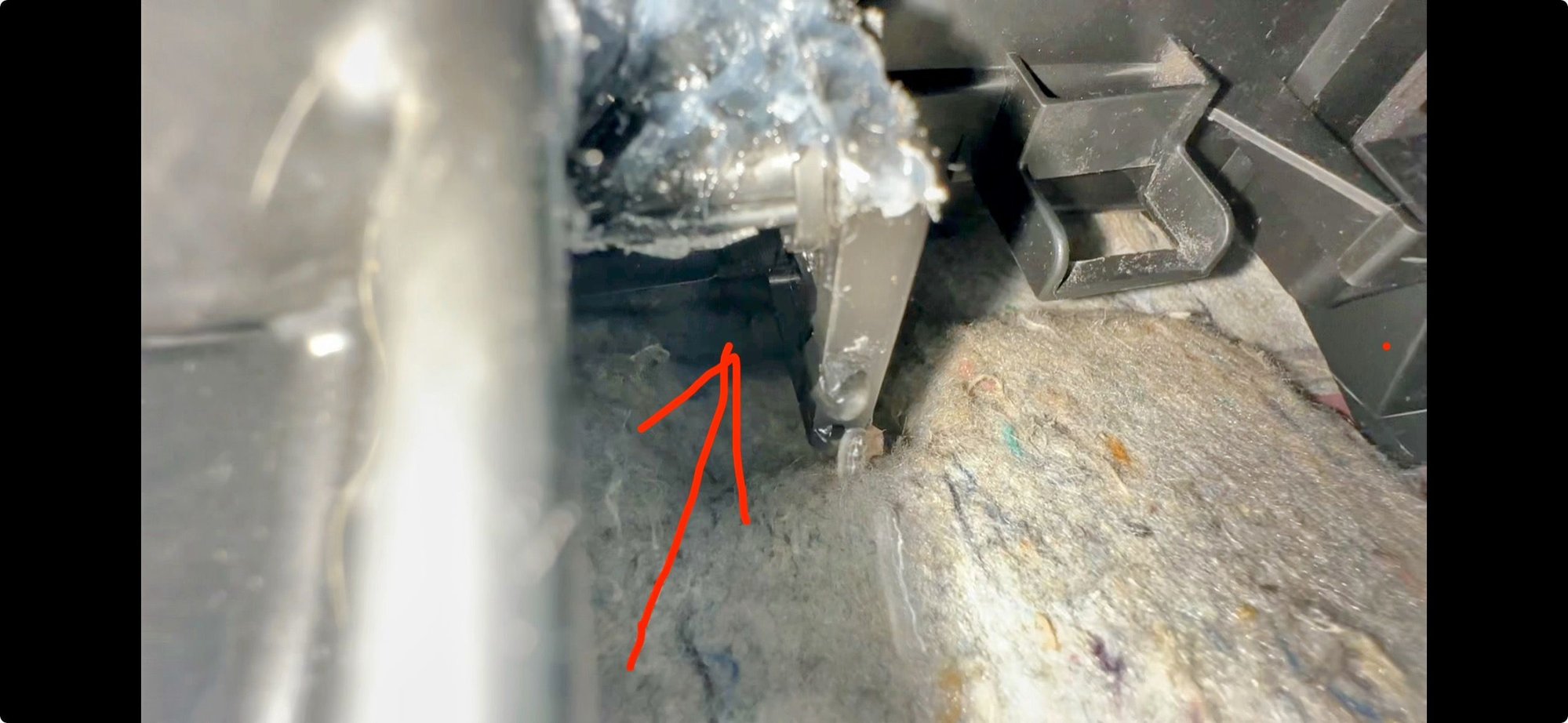

Recently I've noticed some water leaking onto my passenger's side footwell. Originally I thought it would be a clogged AC drain tube, which is pretty common, but water *is* draining out of the tube under the car next to the sway bar. I tracked the secondary source of water down to a seam in the plastic box above where the AC drain tube goes into the floor. See photo for details:
Water is leaking from the indicated area, along the seam in the plastic.

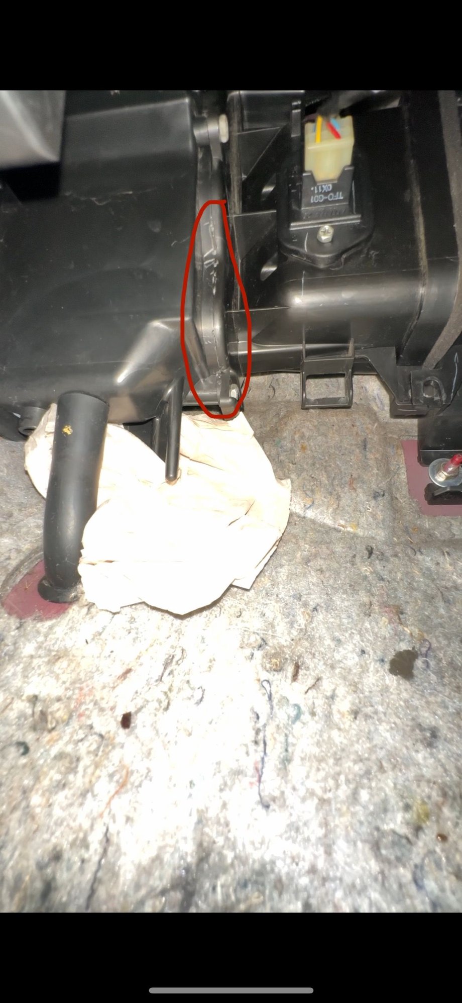

Wider view of the leak area. You can see the drain tube in the left middle of the photo. The leak is coming from above that.
Anyone know what this plastic part is (part # if applicable) and whether it would make sense to replace it, or just seal the plastic with something waterproof?

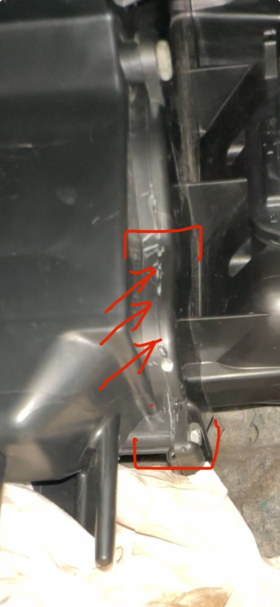

Quick update. I spread some LOCTITE silicone sealant over the area that appeared to be leaking. Water has stopped leaking from there, but it’s now leaking from above and behind that area.
I don’t have much visibility to the back side… I can try blindly spreading some silicone up there, but I might be better off removing the plastic and repairing it outside the car or just replacing it.

Thanks. Based on the diagram, I think that #16, the drain hose, is the hose in the center-left of my second picture above. In the diagram, it connects to the bottom of #7, the heater unit, and there's a drip tray underneath the evaporator, #14 which directs the water down to the hose. t looks like the place that I *thought* was a crack is *actually* a joint between #7 the heater unit and #11 the duct set, which I believe connects over to the blower. So my guess is that #2, the seal between the evaporator side of the heater unit and the duct to the blower, is failing and needs to be replaced. I'm thinking I might be able to remove the screws holding the heater unit to the duct, pull them apart, and replace the seal. Of course I did just seal the joint together but I think I should be able to clear it off easily enough....

Update: I replaced seal #2 in the diagram above (there is only one seal despite it being listed 3 times - I think that's it bridges several different assemblies). I removed three of the four screws running up the joint between the heater module and the duct to the blower motor (listed as screw #22) - the top one was too difficult to reach. I also removed the blower motor and several of the nuts bolting the blower fan enclosure to the firewall (not on this diagram). This made it easier to spread the ductwork apart and replace the seal. The seal is also a bit tricky to get in place due to it being way up in the business and having to work upside down.
But now, no leaks!
