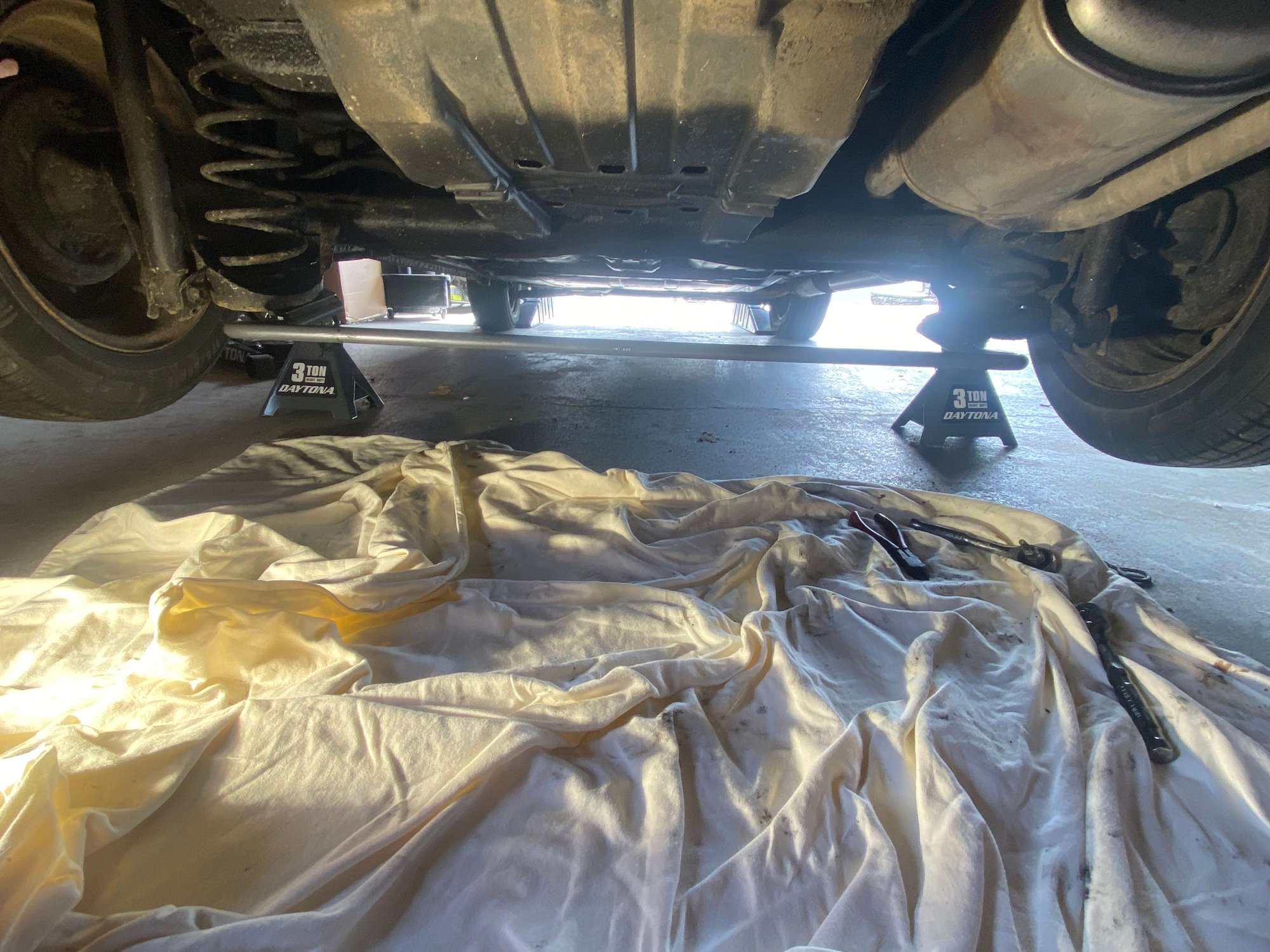

Progress Swaybar Install
I got the Progress rear sway bar installed today. It was kind of a PITA to install, but was not too bad once I got the car on jack stands. I first tried to install it with the rear wheels up on ramps, and would not recommend that. Getting the car on stands allowed much more clearance and made the job a lot easier.
You will need a torque wrench, 6mm Allen wrench, and 17mm socket. Would recommend anti-seize for the bolts as well. The instructions say you need to remove the rear wheels and springs, but I didn't need to and don't think it is necessary. All but one of the bolts fit fine with no modification, but one of them I had to trim the rubber seal on the bottom of the PS shock a little bit to get the bolt in. (You will need to do this whether or not you remove the springs first).
I took the car for a super quick test drive after install (like 4 miles), and it is bottoming out over bumps and making yucky noises. Here in ME we have shitty roads with a lot of pot holes and frost heaves, and I am sure it's fine on decent flat roads. Part of this is probably due to my car having very worn out OEM suspension (77k miles and probably the factory suspension) so I think some stiffer coilovers would help with this too.
Honestly, I noticed minor differences in cornering. But I haven't driven much, or very fast/aggressively yet after the installation. All of the install videos I have seen have people saying this makes a HUGE difference and is one of the top mods to do to this car. Depending on who you are and what you want out of the car, this may or may not be true.
EDIT: I believe I have installed this backwards What a dummy. That might explain the bottoming out! I just found a DIY guide that has the bar installed facing the other way. I will need to flip 'er around - the below pic is how I have it installed
This is the right way to do it (second photo is the area I had to trim the rubber to get the bolt through):

Old Mar 22, 2025 | 07:40 PM
Drew21's Avatar
Joined: Oct 2020
Posts: 895
From: MA
Yes, that's backwards. It should tuck up relatively tightly against the existing suspension components for obvious reasons as you discovered during your test drive.
Old Mar 22, 2025 | 08:57 PM
Douggyfr3sh's Avatar
Joined: Mar 2025
Posts: 8
From: Maine
Yeah - whoops. I will be flipping it around tomorrow
