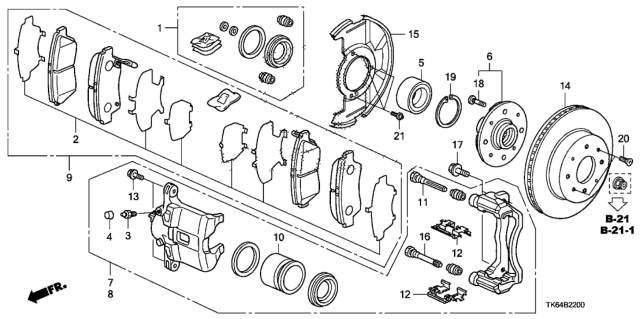

Do our caliper pins have bushings on the end? I cannot remember.

I changed mine at the end of March. They looked OEM and did not have any bushings or o-rings. My new ones from NAPA have one rubber bushing per set of 2 pins.
I think, rather than bushings, the OEM pins have a flat side on them to prevent binding.

I have a 2010 Fit Sport. I inspect my brakes (pads and rotors, drum and shoes) and clean and grease my slide pins when I rotate the tires, which is once per year with the amount of driving I do.
One pin has the rubber bushing while the other does not. I can't remember without looking, but I'm about 80% sure the bottom/lower pin is the one with the bushing. A couple years ago I replaced the rubber bushing and the slide pin boots as preventative maintenance. I use a Sil-Glyde product as recommended in the video above.

Looks like "Pin B" does have a bushing. I wonder if mine are jammed in the other side of the caliper...
https://www.hondapartsnow.com/genuine/honda~pin~45263-tf0-g01.html
