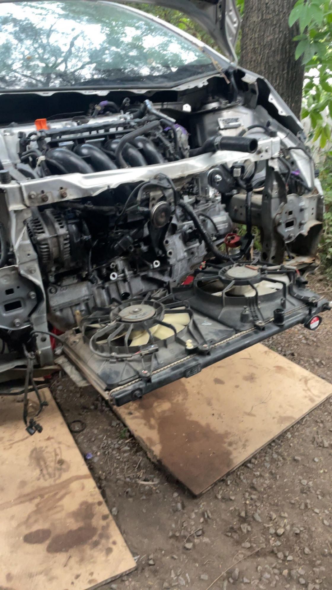

Have a 2008 GE Honda Jazz im currently swapping and im trying to figure out my radiator situation. Cant seem to find much information regarding shorter front ends or jdm front ends. I would like to reuse my original GE radiator but i may have to get a swivel neck because the RH fan hits the stock thermostat neck. If that doesnt work out i might end up using an EK Civic radiator as its half size and could be easier to adapt a plug.

Would be interesting to know the thermal generation per cu/ft with K swap vs 1.5... Go bigger maybe?
