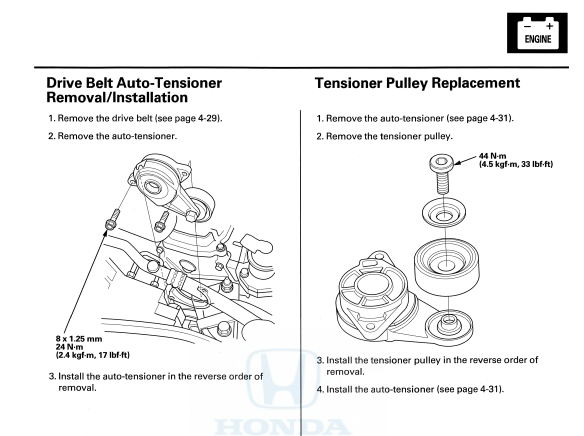

Can you clarify whether you need a new tensioner pulley or a new tensioner? They are two separate parts, and you can purchase just the pulley or the tensioner + pulley.
If you need both parts, RockAuto claims that Litens is the Original Equipment Manufacturer and you can get the Litens tensioner and pulley (part #999249A) for $71. If you only need the pulley, you can get that for $25.
The Gates belt will be fine.

It is one part in the sense that the two parts are attached to each other; it is also two parts because... it's two parts.
The belt tensioner has a pulley on it, which we can call the tensioner pulley. Either or both parts can be bad. In your initial question, you asked if the Duralast tensioner was any good. I have no idea, but if only your tensioner pulley is bad why replace the original Honda tensioner?
I will note that the Fit service manual provides instructions for removing/replacing the tensioner pulley, and you can definitely buy the tensioner + pulley or only the pulley from Honda, so there are definitely two separate parts.
I would ask for clarification as to which part you need before agreeing to the repair.

The bearings are in the pulley - that's how the pulley spins millions of times over 100K miles.
Unless something catastrophic happened to physically break the pulley (unlikely), when they say "the pulley is bad" what they mean is the bearings in the pulley are worn out. As the other poster suggested, you can replace the bearings yourself if you're a DIY person. Most will just buy a new tensioner pulley. Or, for a 2012 Fit, it wouldn't be out of line to replace the tensioner + pulley and hopefully be good for another 13 years. In a previous post I gave a suggestion for what is probably an equivalent part to what you would get from Honda, but at a much lower cost.
Note that most mechanics will install parts you purchase. For example, if they say "we use Duralast parts" and you have a suggestion from the other poster that that part might not fit well, you could suggest sourcing your own part and having them do the install.
In addition, the Service Manual outlines a couple relatively simple procedures for testing the tensioner. The most basic doesn't even require you to remove the tensioner from the car, you just watch it in operation while the car is idling.
