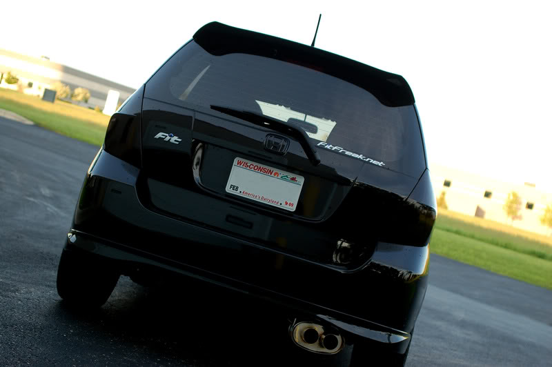

I sprayed mine with vht spray tint.
That is 3 layers of tint and 2 layers of clear. 1 layer of tint is pretty light.

Just so you know if you go as dark as I did the light doesn't come through during the day very well so you will have to rely mostly on your third brake light during the day.
i never knew that was a tint job. i seen pics of your car
before on here but i just didn't know.
just wanted to say excellent job well done.
looks very good on your car.

Good heads-up on the daytime uni-brake. Frankly this alone would be a reason for a cop to pull me over, that and someone rear ending me, one brake is a real issue.
Looks great parked though.
Old Nov 25, 2008 | 07:15 PM
Previc93's Avatar
Posts: 1,127
From: GILBERT AZ
Ya they are kind of dark in the day but i think the law in az is that the lights have to be seen for over 100ft. which you can see. but it still is kind of dark in the day time. I havent been pulled over yet... knock on wood... but i like the way they look. also if you get rear ended its the driver behind you at fault. whether brake lights are working or not. they should have been following so close. but you also dont want your car to be hurt either.
