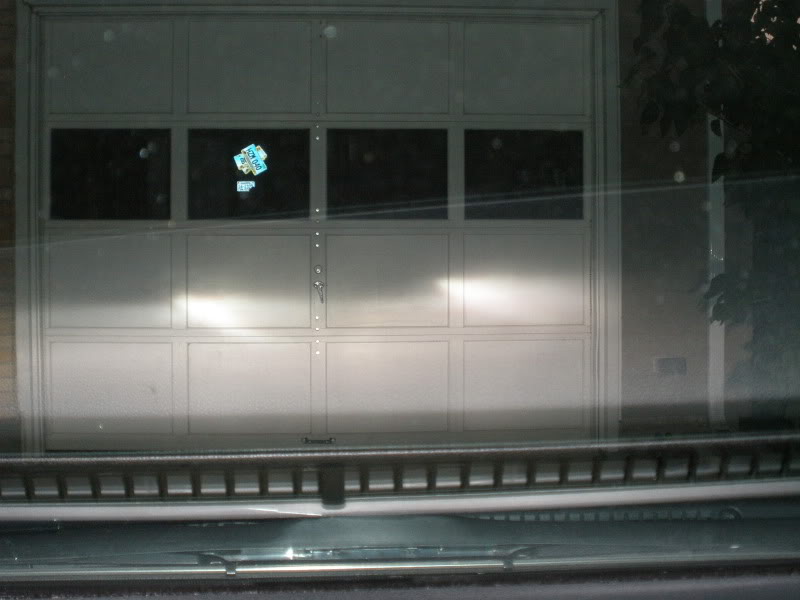

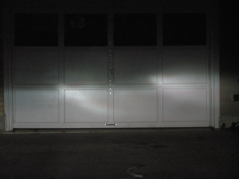

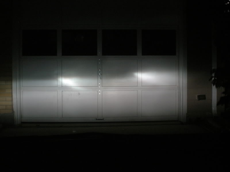

I understand people are gonna hate, but I promised these HID pics. It's on an incline cuz there's no driveways around here NOT on an incline, but the pics are of ~10 feet, ~20 feet, and ~30 feet away. I'm not on a sideways slant...the left headlight IS lower and DOES cut off at the top, only not as sharp as the projectors do. I'm not going to argue with anyone, but I know I can see the left headlight is lower than the right one. The left one's center is approx. 3 feet off the ground at 30 feet, so I can't imagine how high it looks at 50-100 feet. That's all I'm gonna say...I promised to post my pics so I did, but I'll take any CONSTRUCTIVE criticizm (i.e. any way to make them better, besides ripping them out and putting projectors on, of course). Thanks!

Unfortunately the only thing you can do to improve the beam pattern is change the design of the reflecting portion of the system. So either redesign the headlight housing (hard) or install projectors (easier).
