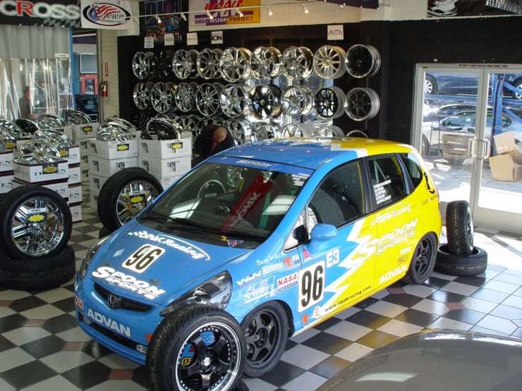

But if you're going for max lateral G's (handling) & better acceleration I'd find a light 15x7 (Rota, SSR, Motegi, Konig) & sticky 205/50 tires like Azeni, Nittos etc.
I think Spoon knows a thing or too about this subject lol.. 1.09 G's grip on 185/50 Advans & 15x6.5" Spoon SW388 wheels.

They may know that they are doing but that is a first gen Fit. This section is about the 2nd gen Fit. Quite different when it comes to wheel size.
Old Jan 14, 2009 | 06:42 PM
Import Al's Avatar
Joined: Dec 2006
Posts: 104
From: Middletown, CA. United States
True true.. my point was that dimensions & suspension-wise, not much drastic has changed from GD > GE so it would be logical to assume a light, wide 15" wheel would be good for handling & acceleration (by lowering effective FD ratio) like on the Spoon FiT.
There are lots of light 16x7"s out now though, & the performance difference would be negligible so just pick what size you like.
