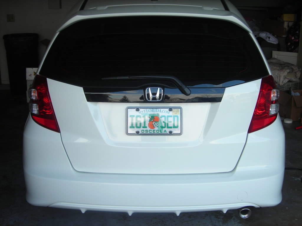

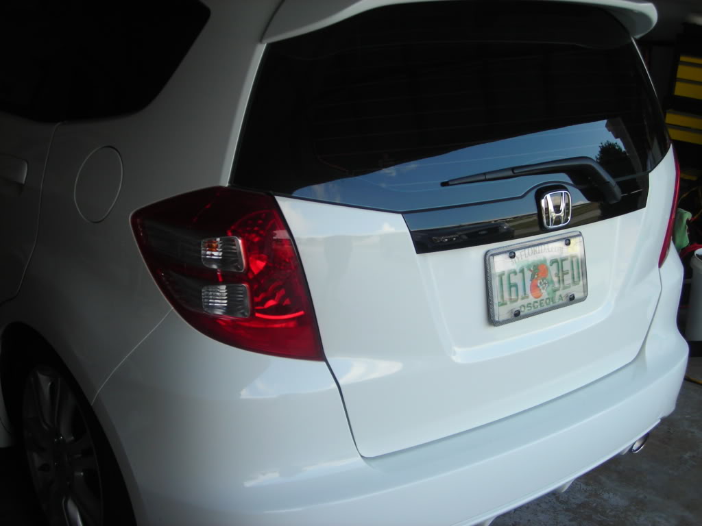

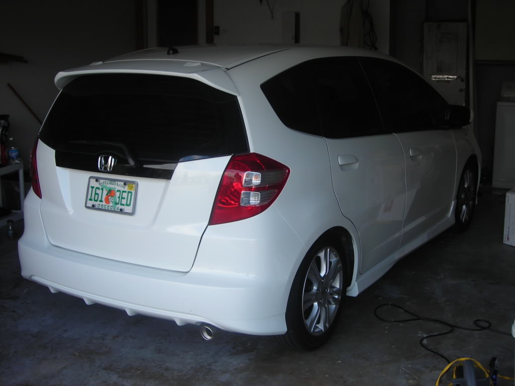

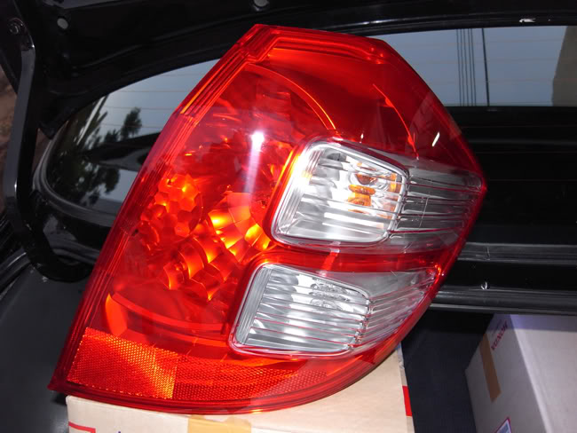

Hey guys just got my lights from thailand!
Install was fairly easy, hardest part was trying to stretch that brake harness wire and plug it into the bulb. You have to stretch it about 3-4 inches and theres very little room. Plus I also dropped one of the 8mm nuts into the abyss. Make sure you have extra nuts cause if you dont it wont sit flush.

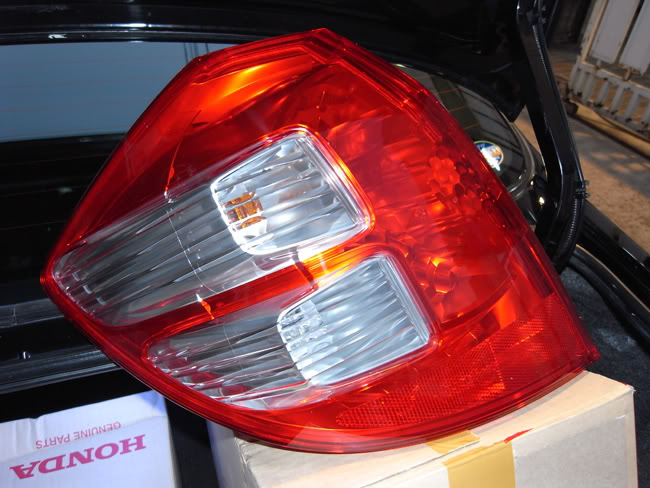

hi everyone
i am a friend of Squawking7500 that exchange the taillights with Qbmurderer13.
i have the other pairs of the taillight.just tell Squawking7500
the shipping cost from bangkok thailand by thaiiland post to USA around 100++ $ up to its weight.
and it take around 9 to 10 days by EMS from bangkok to Qbmurderer13 ORLANDO, FLORIDA.
you can tracking from the thailand post web (http://track.thailandpost.com/tracki...t.aspx?lang=en)
til it's arrive in USA and also after that you can tracking from your USPS web (http://www.usps.com/),
i and Qbmurderer13 used both web now the taillight installed at his car and i'm waiting for mine.
the taillight from here thailand weight around 1.2 kg. per side.after i packed in to the box it's weight around 3.5 KG

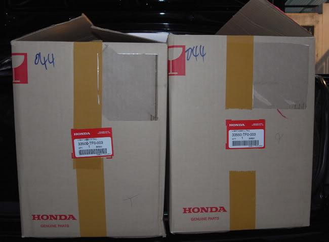

AND to confirm Squawking7500 that the part number in thailand for the L + R taillight are
33550-TF0-003
33500-TF0-003
