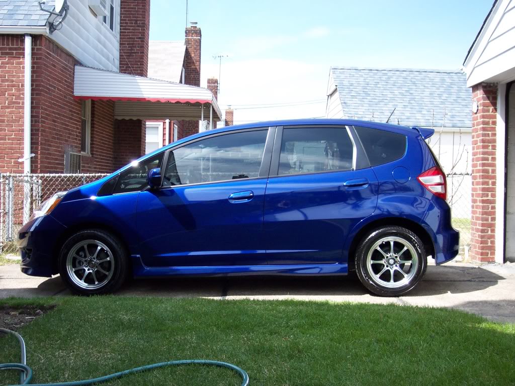

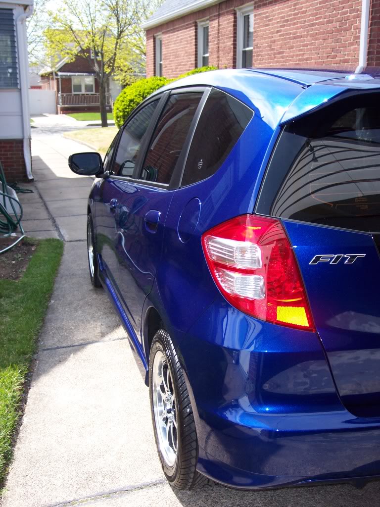

I am currently running +38 offset with my 15" rims and they don't rub at all at stock height. The front stick out beyond the fender much more than the rears so i am gonna guess that with a mild drop they could rub especially with 16" rims.
I can take pics once the weather is warmer and sunnier to show you an idea of how much they stick out if you like.
You can kinda see the wheels sticking out further in the front than in the rear with this pic.
If you need any more pics to help answer ur question, just let me know. I know mine are 15" but the offset is +38mm.

here ya go

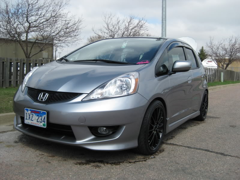

it wont rub i had +40 16s and they werent even close to rubbing. and now i am running a +37 offset 18's with 215/35/18s on DF210s and it doesnt rub at all. 90% of the wheel fitment posts on here are speculation. i have actually tried a few different ones and havent had any problems... especially with stock tires
..... reaaaaaally..... have any pic's showing how much your tires stick out in the front..?? like a shot coming straight down from the fender to the ground..??... because I have to see this.... I'm running a 18x7.5 52mm offset up front and rear with a 215/35/18 ( with camber bolts ) and I barely clear/ tuck up front with -1 deg camber...

ya i will put one up later today

best side view i have for now i took wheels off to get powder coated.
Are you getting a lot of negative camber from the drop on DF210's? Have you done a speed bump test with a couple of people in the backseat?
I am not that familiar with the new Fit, but there are lots of people were reporting rubbing issues even with stuff that worked on the GD3; 215's with a +37 offset should rub like a son of a bitch lol
Thanks for the post, rims look great btw!
Old Apr 24, 2009 | 07:37 PM
GE8's Avatar
GE8
Posts: 115
From: Sioux Falls, South Dakota
i actually had a alignment done and it it was within factory spec on the fronts and rears were a little off since they are not able to be adjusted. and i live in south dakota lol every road is like driveing over a speed bump. i have a system in the back and had one person back there and hit a few big bumps and it didnt rub one bit. it is very close (about a 1/2 inch or less) to rubbing the fender liner near the door. and thanks i usually dont like big wheels but these look pretty good imo.

Tork's Avatar
Posts: 1,251
odd that GE8 seems to have a bigger gap than about any other dropped on DF's ge that I have seen a picture of. That is how he is getting away with it.
Cant figure out the gap, is it bump stops not trimmed that would cause no rubbing also!
Not sure about OP's Toronto location roads, but that offset in Northern IL, SE WI would not cut it after this past winter tearing up the roads. And those 18's (nice style to the wheel by the way) would not stay round very long.
I know the bump stops are not easy to get out of the sleve to cut, did that get skipped?
