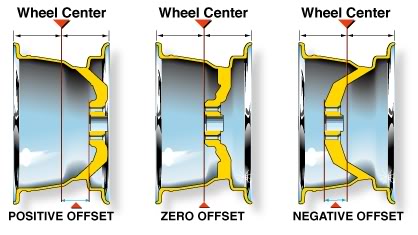

Old Apr 23, 2009 | 11:50 PM
it's pronounced iVTEC's Avatar
Posts: 929
From: Fort St John, British Columbia, Canada
wheel offset is distance between the wheel centerline and the hub flange (where the wheel is mounted to the car)
the higher the number the closer to the engine the wheel would be, a +30 offset would be farther away from the engine and the wheels would usually stick out from the fenders depending on the car, and a +50 offset is the opposite, it makes the tire sit closer to the engine
offset also has a major effect on drivability too much offset and your car will be much harder to drive, and vice versa
pretty good explanation
