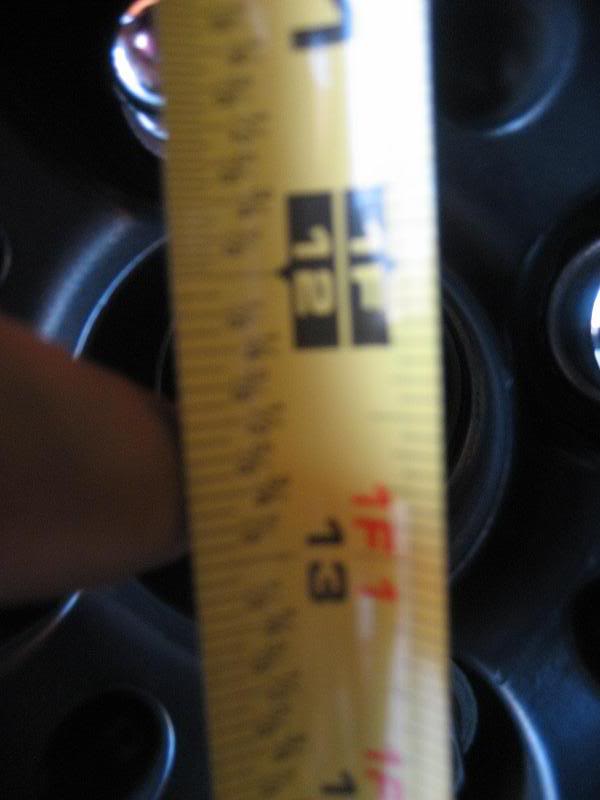

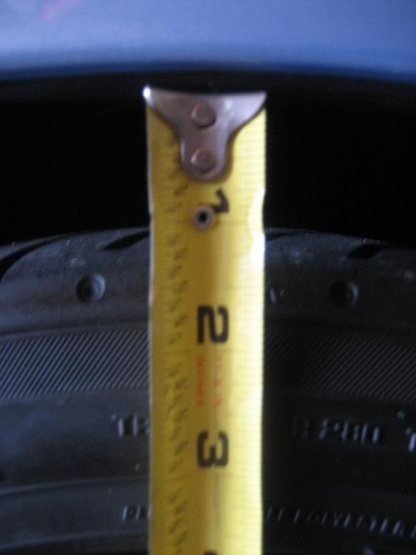

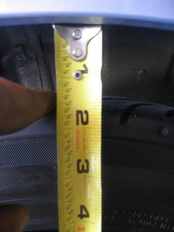

here u go bakedcookies...
GC heights for these springs
front - 375lb/in by 6"
rear - 175lbs/in by 8"
lowest setting
front center hub to fender - ~12"
rear center hub to fender - ~12.5"
FRONT
REAR
*note* again.. your wheel gap would be different because my tires are too small...
