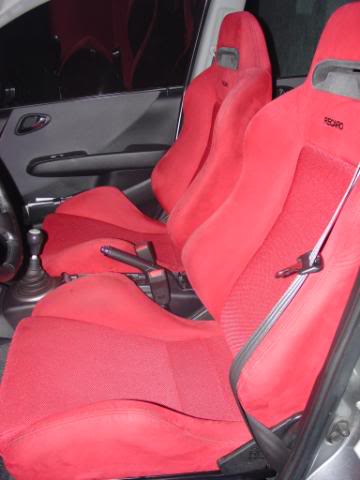

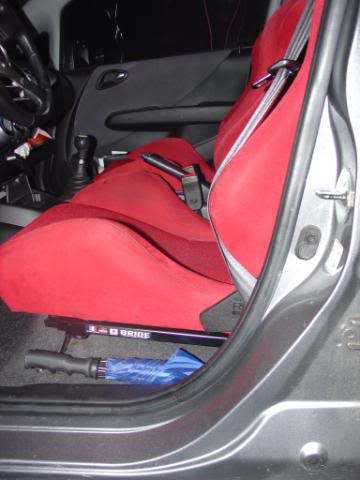

http://bride-jp.com/r-pdf/honda_090302.pdf (PDF file, parts list)
Bride makes RO-type rails for the GE Fits. Those will mate with your Recaro SRDs, no problem. I know because I DIY-installed my own SRDs on them, although my car's a GD1.
http://bride-jp.com/pdf/recli-2.pdf (PDF file, install guide for the RO-type seat rails)
The RO-type rails themselves are standard; it's just the feet at the bottom that will differ with every car.
