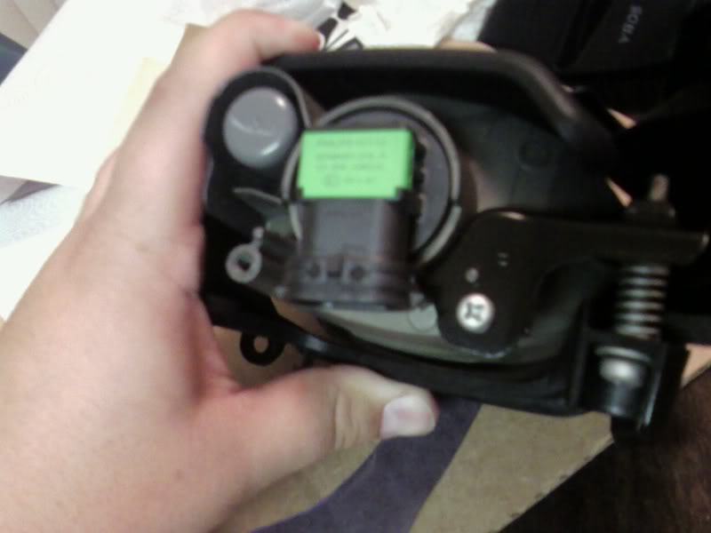

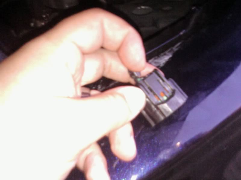

So next you have to disconnect the plug to the light bulb, Just push down on the black tab and pull out... Im pointing at the part to push down to remove plug

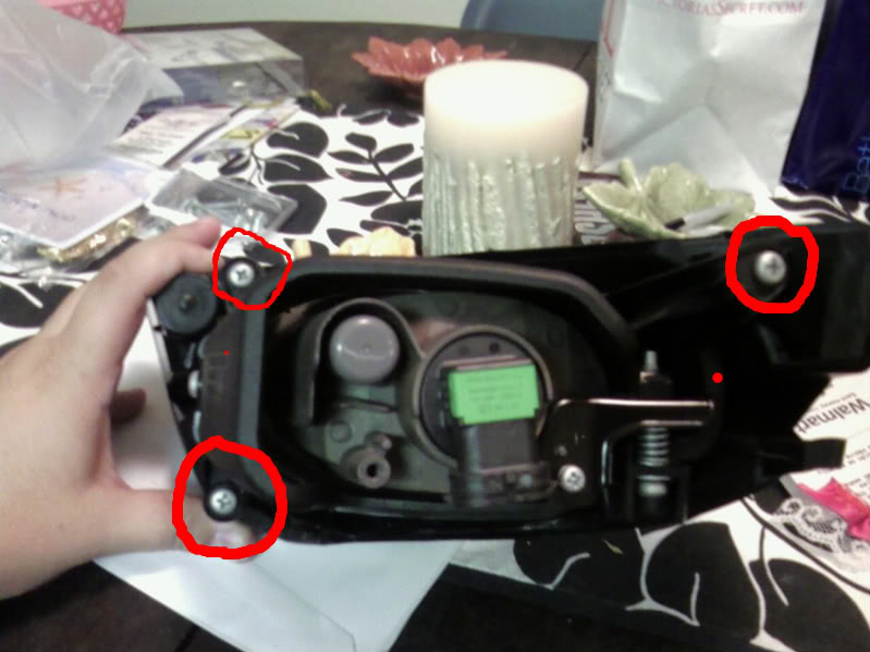

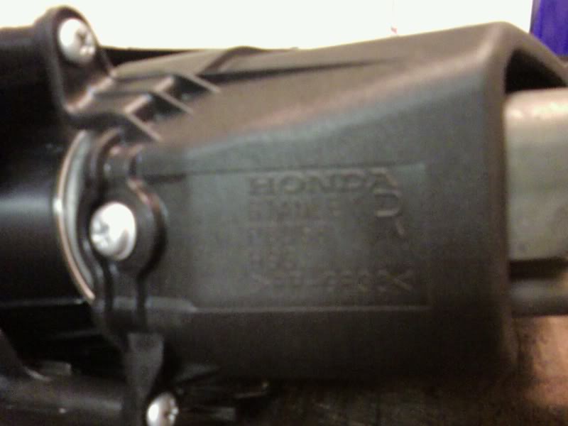

Now once back inside with the AC on high you will notice 3 screws on the back of the unit. Remove all three

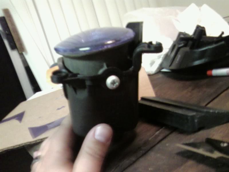

next after we remove these we will need to remove the rest of the housing... there is one screw on the side and one on the back.
Size:  39.6 KBAnd the other screw is right here
Size:  33.9 KBdo not remove the screw with the spring because it seems to be the beam adjustment and we do not need to remove it. As you get to this step do not force anything because you will have to wiggle the light out of the housing.

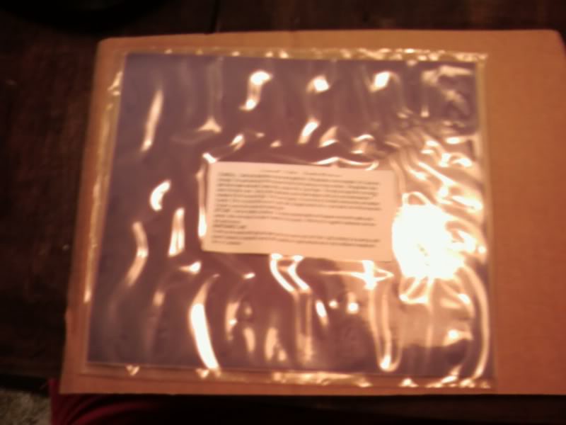

Now we have our light out and ready for laminating. It is shiped in a manilla envelope with cardboard so it does not bend. It comes with printed instructions that say for small applications we do not need to wet the lens like you would if you were doing head lights or tinting.
(I purchased the optic blue color but I know most of you will want to do yellow)

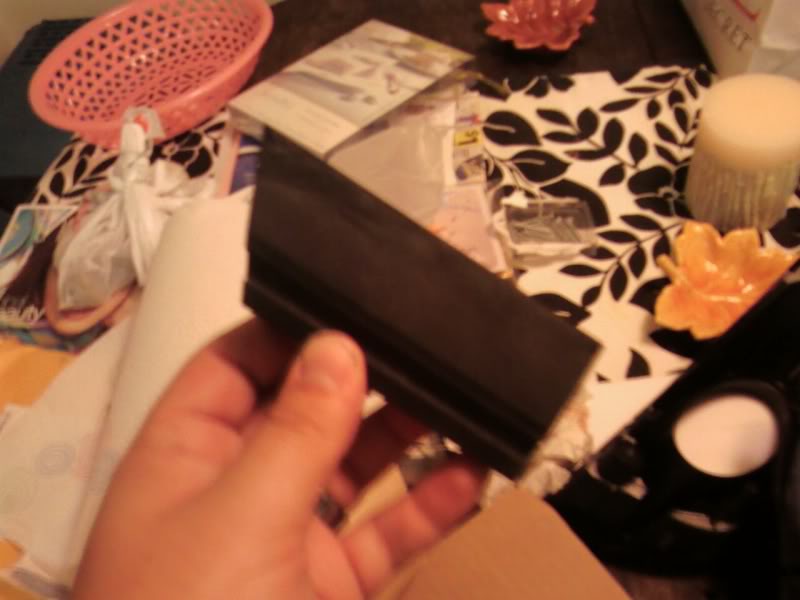

Here is a picture of how thick the lamin-x is

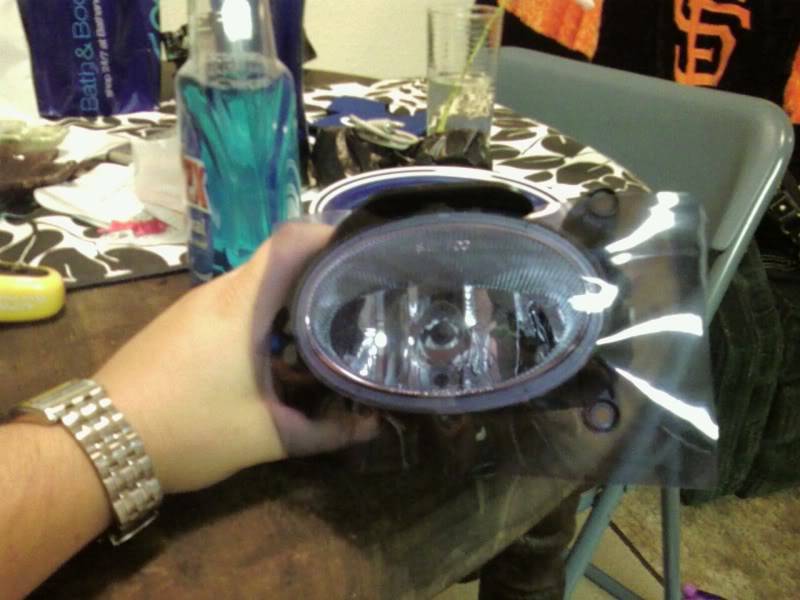

I just cut this in half and stuck the center onto the center of the lens.
Next I roughly trimmed the edges so I could work the edges better. No pics since these are prety self explanitory steps...

Next once removing all the air bubbles you will see that the edges do not roll well around the edge so I took a blow dryer and heated the edges of the lamin-x and then the edges curved over easyer and stuck.

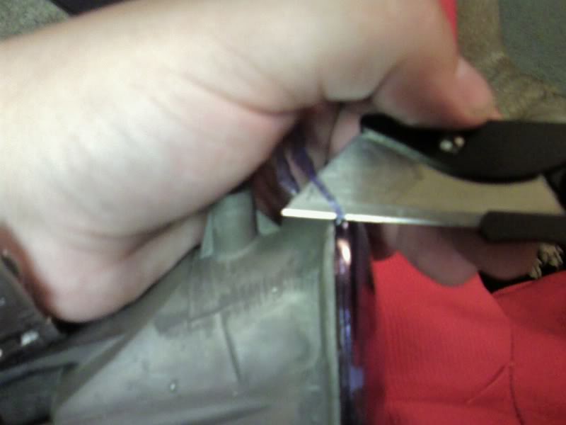

Next final trimming with a razor blade to get all the excess off

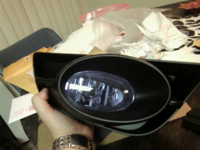

Now just re-assemble everything back and you will have something that will look like this

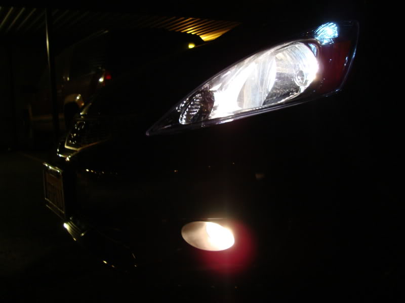

After re-instaling this onto the FIT I can see that the optic blue does not change the fog light color at all... But all is well and most of you will use yellow anyway. (So wait to change your bulbs too so you can kill 2 birds with one stone!!)

Nice write up man, got some night time pic's? i put Lamin-x on my R6 the gun smoke color and i lost abit of light.

Yea I'm back from my Hiatus from FF. Got some more money to waste Speaker Install coming up next
Too late tonight to take out the car for night pics but tomorrow will be uploaded... still look pretty yellow

Ok here is what it looks like with stock bulbs still in the housing.
