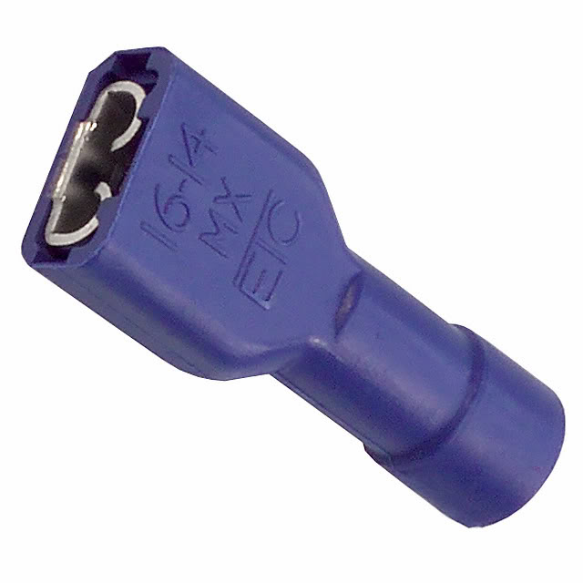

Originally Posted by KyleJ
Are there any special connectors I need or do I just need to get the plugs and covers from Honda and solder, crimp, etc. them up myself.
You just need a couple of "quick disconnects" or "slide connectors" or "push on connectors". Below is a pic of what you need (female end).
BTW, spade connectors are the ones that are forked. For the longest of time, I thought the quick connects were called spade connectors, because the make part resembles a spade (shovel).
Thanks. I should have those lying around.
