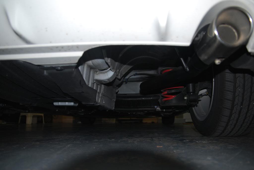

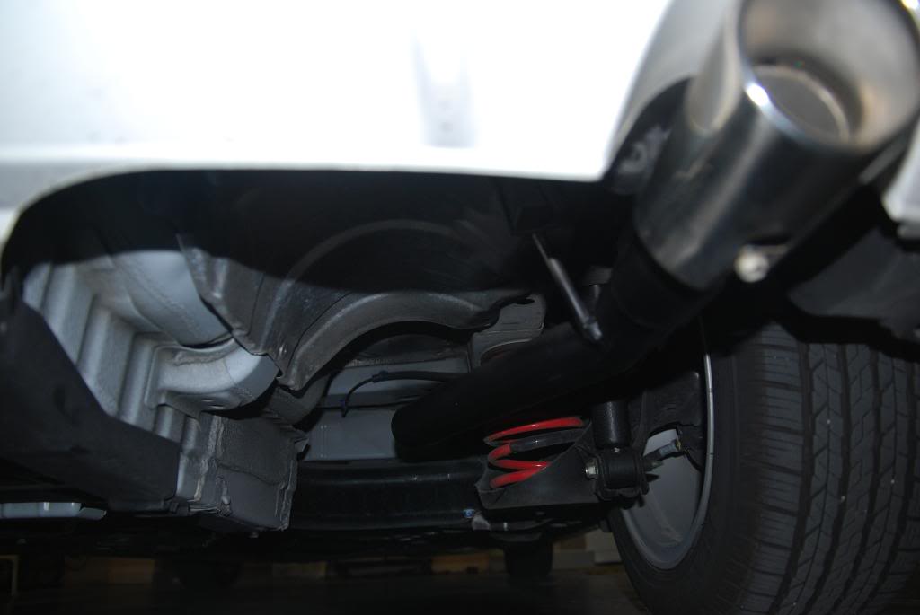

Just got this done recently due to the suggestion of a friend on here Credit goes to him when he shows his face.
Got my muffler shop to chop off the axleback and weld on a custom bent 2" pipe and re-use the stock tip. Painted the pipe black for extra stealthness. It is very quiet, sounds just like stock except a tad louder and lots of growl. I would compare the exhaust note to a slightly louder 350z. I know lots of people use that car to describe the exhaust tone but it really sounds like it. Only cost me $40. This will hold me off till somebody comes out with a decent exhaust. Until then, this sounds amazing.

How difficult was it to coerce the shop to bypass the muffler?
Old Jul 21, 2009 | 10:36 PM
qbmurderer13's Avatar
Posts: 2,373
Not difficult at all. They didnt even question me. Just bring cash as they might not want to leave a paper trail. The exhaust isnt loud enough to get you pulled over anyways, and it looks stock. Just try going to a mom and pop muffler shop if anything.

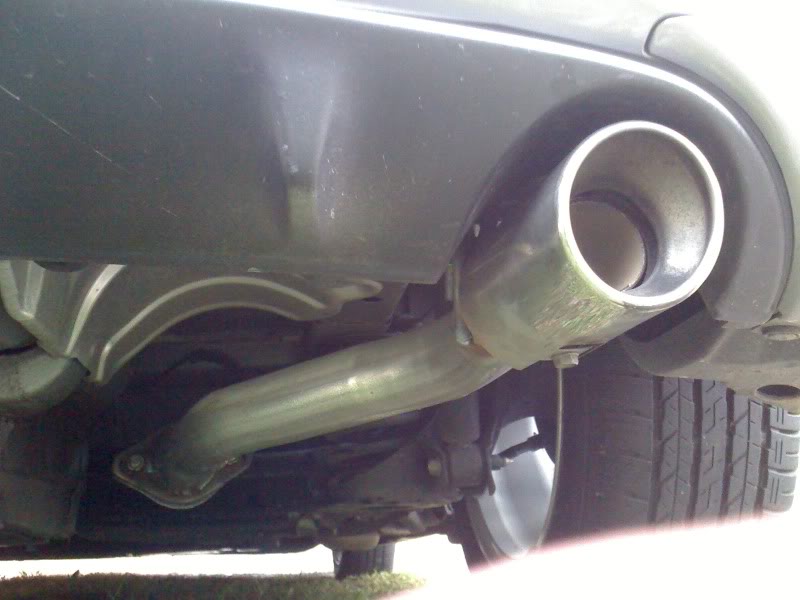

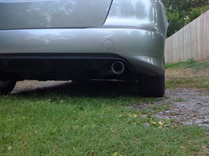

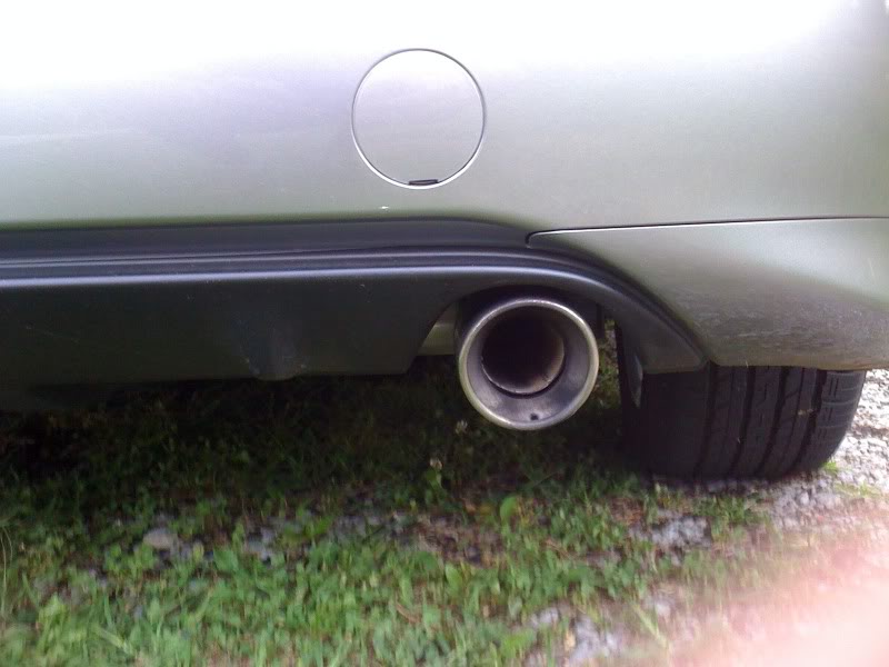

OK OK :P i'll show my face.......If you want the Factory tip you have to use the 2in pipe, even though the factory is 1 3/4.......just trust me. it sounds really good, kinda like a mixture of a 350z/ SRT4 neon. that video is very low quality, i'll make a better one soon, in HD....haha but yeah here is what i had done a couple weeks ago.
P.S
I am able to swap it back to factory if i want. at anytime i want

nice mandrel bends!
