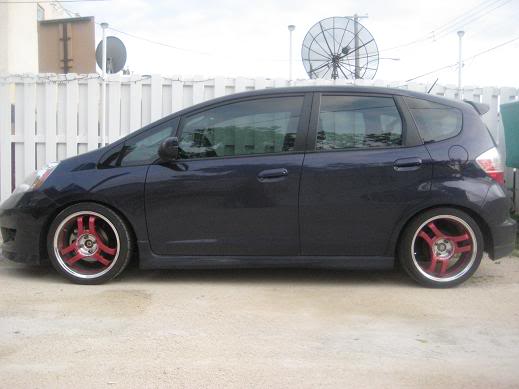

i have eibachs sportlines and i tend to bottom out just the plastic piece under the front bumper
where theres dips but im using 17x7.5 et40 and 205/40/17 tires
and on hard turns theres fender lining rubbing i lost 4 fender screws already but i drive pretty hard sometimes
i think you will be fine if you use a higher offset wheel size and skinnier rim
and with the sportlines the car is more raked
heres some pics hope this helps

umm with my 205/40/17 the front gap a 3/8 of an inch and the rear is 1/2 an inch gap
