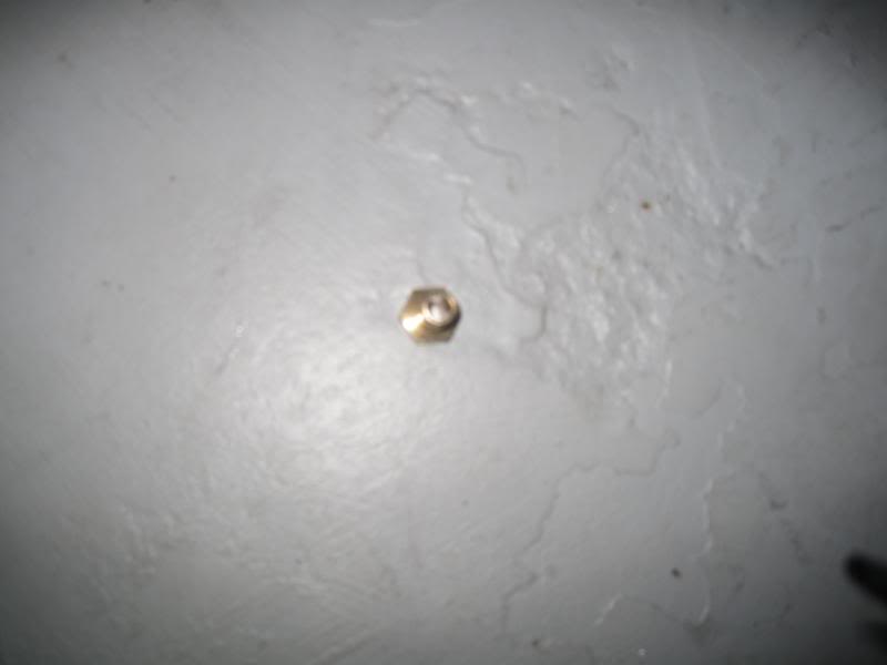

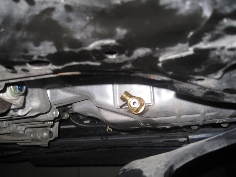

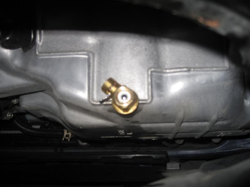

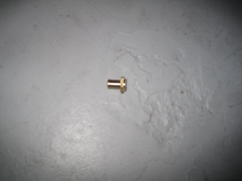

i ordered a f106 valve with nipple a month ago and it was time for an oil change. self explanatory. i go tighten the valve following the instructions
"Since the threads part of Drain Valve is made of Brass and has the hollow construction, install it by hand, and with the wrench, give only a 1/4 turn to tighten it. Please take care not to over tighten."
i did exactly that and use a 5 star wrench and the nipple breaks. i emailed fumuto and i want to know exactly how am i supposed to get this thing off? i'm trying to find someway to get this piece of crap off.
btw, i have installed fumuto valves before. this is the first time this has happened to me.

i did the oil change around sunset and by the time i was done it was dark. worst pictures but the general point is seen. the 5 star nut is attached to the nipple and now i dunno how to get the valve off since it broke off.

BS - how do you think people install valves that don't have nipples @#$! My Fumoto has no nipple and I can install and uninstall it easily. Take an adjustable wrench and put it around the square body of the valve. You broke it off because you were using the nipple to install it.

thanks guys, i'll try the adjustable wrench.
the fumuto guy called me up and said he'll send out a replacement. he said this is the first he ever heard of this. he said he wants me to send it back the old one whenever i do my next oil change so he can look at it.
does mine right now w/o the nipple look exactly the same as the nippleless ones since the nipple ripped off?
