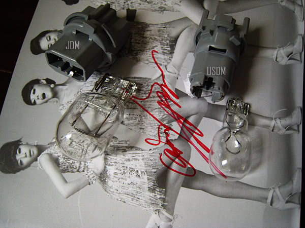

they're not technically "plug n play". one of the sockets for the bulbs are different. yes, they bolt right up, but the reverse light or the blinker socket are a different size. if you exchange with someone over seas, just send the sockets with them. the top clear section houses your amber blinker bulb (or you can get the silverstars that are silver and light up amber) and the bottom clear section are your reverse lights. the only thing these don't have are the reflectors I THINK as far as legality goes. i've never been pulled over about it though.

As long as the tails you purchase come with all sockets and bulbs attached, you are good to go.
Like someone else mentioned, the only difficult part of the install is procuring a little slack on the passenger side. In order to accomplish this, you need to take off and cut off some of the wire holder, and remove some electrical tape. There is also a clip that helps relieve pressure if removed. It took me about 30 minutes on the passenger side. Including time to rewrap the wire in new electrical tape, and 5 minutes on the drivers side (it doesn't need as much slack).
L = JDM bulk and socket
R = USDM
Old Dec 17, 2009 | 12:46 PM
  #32
jnesselroad's Avatar
Posts: 811
From: Clearwater, FL
The socket is also available from your local Honda dealer. It's the reverse socket on an 08 accord 4dr. The bulb is a 9440. I can grab the part number for the socket if you need it.
