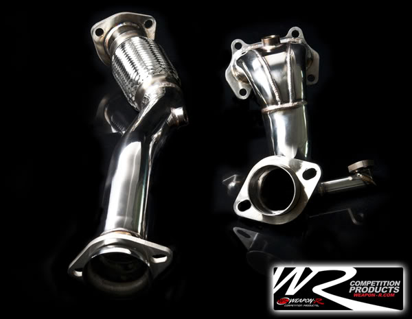

Well that is what I call a down tube or cat delete pipe.

So what's the purpose of it? Just deletes the cat converter to increase flow? But then it won't pass emissions...............

Well the pipe on the right bolts to the head and it would replace the PRE-cat.
The pipe on the left would delete the main cat (I think).
So you could probably use the pre-cat downpipe and still pass emissions with a warm engine. (I did a downpipe pre-cat delete on my 93 RX7 and it still passed)
It is hard to tell for sure, but if the second (left pipe in pic) deletes the main cat then no (if you fit both pipes).
It is a bit hard to tell from the one pic. But it is possible maybe to use the pre-cat delete only, add HP if it flows better and still possibly pass emissions. We need MORE info on that item!
One clue I may have it right is the location of the 02 sensor bungs.

Here are two pics of a header/whatever from Works Engineering. Looks nice to me...

That helps,
so The weapon R is a precat delete and by the braided flex pipe material, looks like a main cat delete also (provided you use both pipes)
Now on the Works pic, it looks like a precat delete also, but the pipe just above the long B pipe looks like it has a new main cat included. (shaped like a cat at least)

I'm in CA. so my stock cat has to stay on. Will Weapon R sell just the pipe on the right that bolts to the head?

You could just put the cat back on for inspection! And I don't think WeaponR has put it into production yet.
