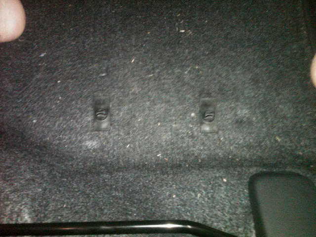

-Floor mat anchors, if you order from the site I used, I would suggest buying something else as well because shipping was crazy high for just 2 little clips, but my buddy wanted an Accord horn for Si so we split the shipping. This is the cheapest site I found for them.

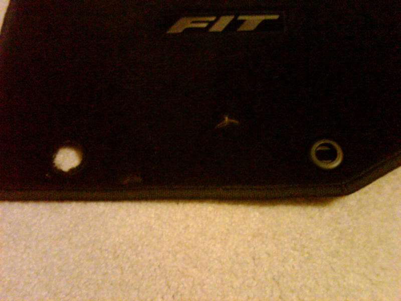

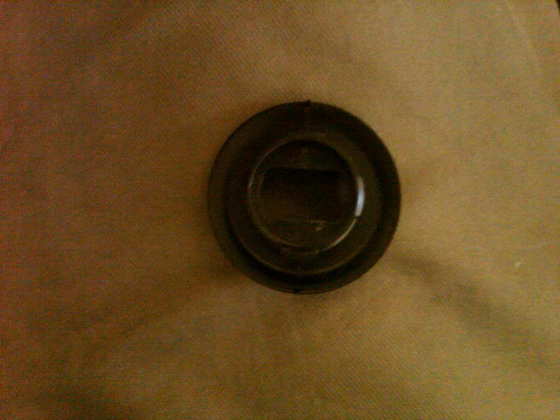

-The part that the clip twists into (sorry I have no clue what they are called ) But I resurrected them from my old carpet mats from my old fit. For easiness I'm gonna refer to them as the 'plastic circle'...hehe

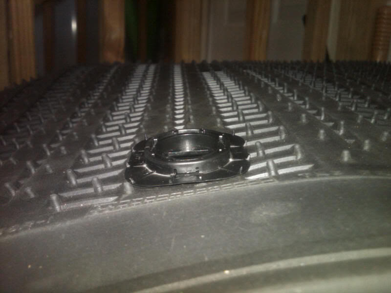

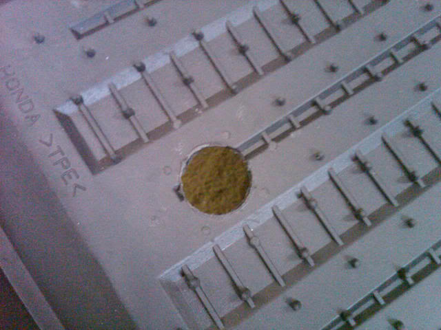

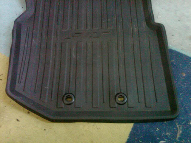

take the pipe and heat the end up with a blow torch! The thing about doing it this way it is one clean cut and the melted plastic seals the hole. but you have one chance at doing it. You could use scissors if you wanted but I wouldn't recommend doing it that way
also pluck off the little rubber poky things off around it so the backing sits flush
repeat for the left side

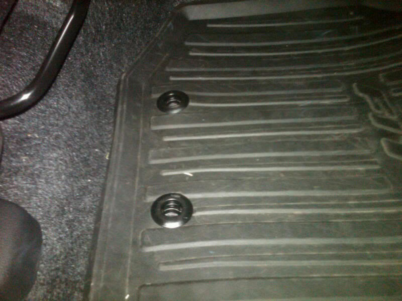

then simply slide the 'plastic circles' in and clip the backing on
TIP: put the backing on the opposite way, I found that it is more secure this way

next you will need to take the clips and install them in the carpet like you would the drivers side.

throw the mat on and twist clips to secure (duh lol)
after that you're done!
