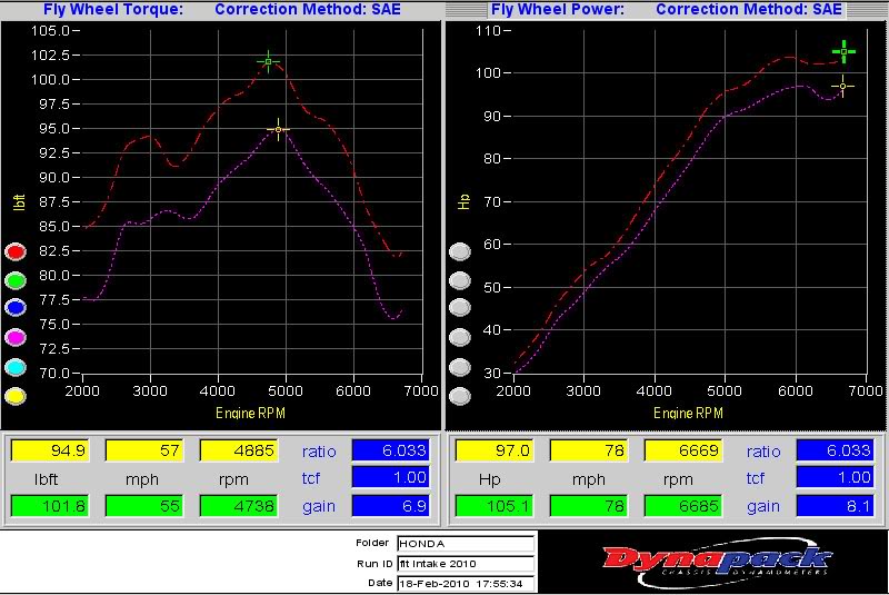

This is the dyno they sent me...it just seems too good to be true for a bolt on. Absolutely no dips below baseline anywhere in the power curve...I have never seen a header produce such a dramatic increase in TQ "area under the curve." Usually headers only produce increases in high RPM HP cause this is usually when the OEM exhaust is flow limited.

so would you that this is an inaccurate or false statement made by WR? I thought we were going to chip in $10 each for someone to get the WR and dyno it?

I don't want to say they're lying...that's putting it out there...what I would like to see is independent verification of the results.
I'm still hoping to chip in to offset the cost of someone taking on this project. Depending on how many people are in, we may have to chip in a little more than $10. I think 3-dyno runs averages $60-100. It would be cool if we were able to pay the entire dyno cost if someone purchased this "header."

the only way they would admit or discard or clarify anything is when those dynos are going to be circulated around FIT/HONDA forums and then scrutinized... then and only maybe then, they would start talking

I agree, especially since some have discovered that the ECU often corrects for modifications with no additional electronic calibration.
The torque graph is suggesting to me that they tuned the runner lengths for low and mid range torque which is easy enough to do, and would frankly make this part more appealing to people who DD their Fits.
What this means is by default it will create more horsepower up top because HP is derived from torque over time.
I would like to see the test unit they used and the configuration it was tested on, as well as atmospheric conditions on site. There could be quite a fudge factor there..

Good points...I always enjoy reading your posts. Thanks for always taking the time to explain your thoughts.
