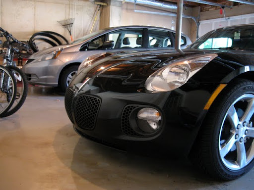

I do have a GM LNF sitting in the garage and am vaguely familiar with the necessity of premium fuel in cars designed for it, aftermarket tunes, and their ability to learn up to a higher level of performance.
And since we're having show and tell tonight:
