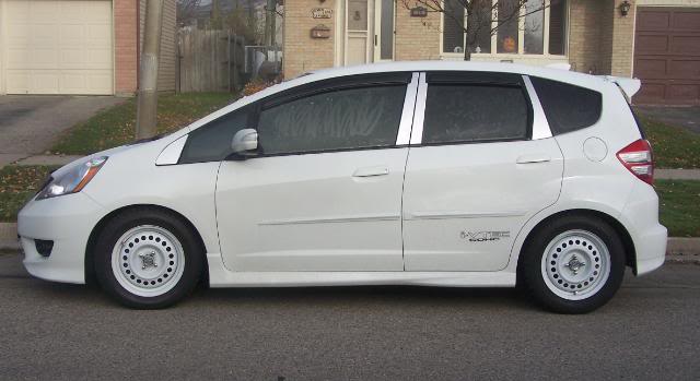

Where in Canada Canuck?
I just put my snows on last week. 185/65R15 BFG Winter Slalom on Honda FIt rims
