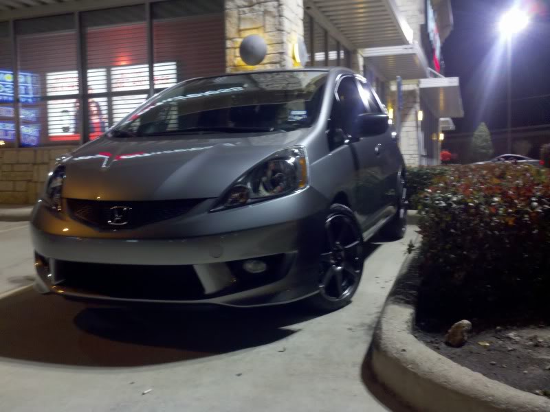

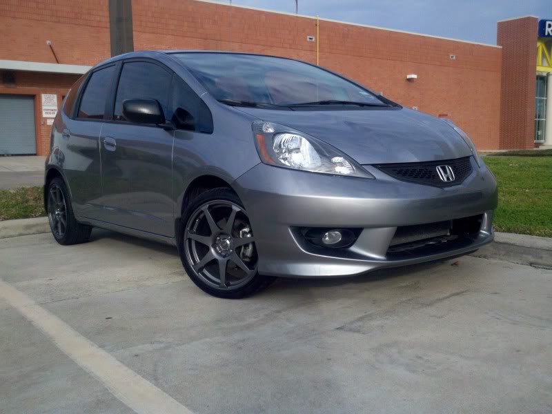

Dropped the base bumper off Friday to get a positive paint match. I take the Sport Bumper in Wednesday. I hope to have it back on the car by the weekend! I need to get those inner fenders by Friday! The car looks great but you went OEM sport wheels. You probably could have got some nice aftermarket ones for less. Unless you got a GREAT price on them.
The SSM paint is a hard match 3 part metallic paint. At least my paint guy was real nice about the rework. I think he cringed a little when he saw it one the car!
Keep up the great work and keep the pics coming as you put the parts on and I'll do the same!

Originally Posted by Ray731
Says you have springs but doesn't look like it. Car would look amazing with a proper drop.
