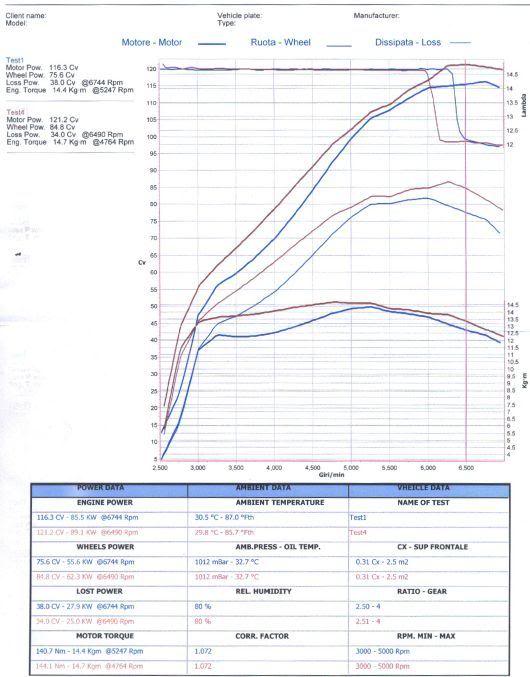

Coyote, I know that you come from the VW world, but you can get a LOT of power out of a Honda engine by swapping cams. The only other thing you need to change when swapping a cam is springs and retainers (fuel injectors might not be a bad idea though).
You should know as well as anyone (with that KW kit) that the L15 bottom end is plenty strong as it is. And we do have a solution for the rev limiter, AFR, and possibly the VTC in the L15a7 (you GD guys are out of luck): The VTC intake cam gear is where the real potential of the i-VTEC engines is.

¿Como? There are lots of people auto-X'ing the GE Fit on this forum...and people all over the world tracking their GE. In fact, the dyno graph that you completely ignored above is from a company successfully road racing their GE.

The dyno I obtained by emailing the company that responded to the "ECU Fit relash possibilities" thread in the GE8 tuning subforum. I believe I have a larger, higher res version (~2 mb in PDF), I'm just too lazy to search my photobucket at the moment. The only point of posting the graph was to show that GE owners do indeed have a way of manipulating all the parameters you posted in your initial response.
