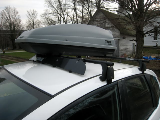

I'm not quite sure what the "flaw" was on the towers but I had my q towers from my 2000 integra GS-R (Purchased the rack in 2000 or 2001) with 48" bars.
All I did was purchase the Q99 clips and replace my current ones with the Q99 clips. The rubber feet and the clips work perfectly with the older towers and I had absolutely no issues carrying the cargo carrier. The bar width is perfect as there is little/no overhang. I'll post some pics shortly - I have lasagna waiting for me.
Update: Lasagna was good. Now for the Pic(s)

Ahh ok, cool. My bar does show a little bit of "scrunched" together plastic from where it sat on the Integra but at that spot, the rack was on so tight that I had a hard time undoing the allen-bolt and freeing up the tower. Since I usually leave racks on the car for a while (and dont' usually take them on/off) this likely won't be an issue for me of grinding down. All I will need to do is regularly check the tightness of the rack which I have done for years anyway. The clips themselves fit perfectly in the older style Q tower. Exact replacement for the Integra clips.
