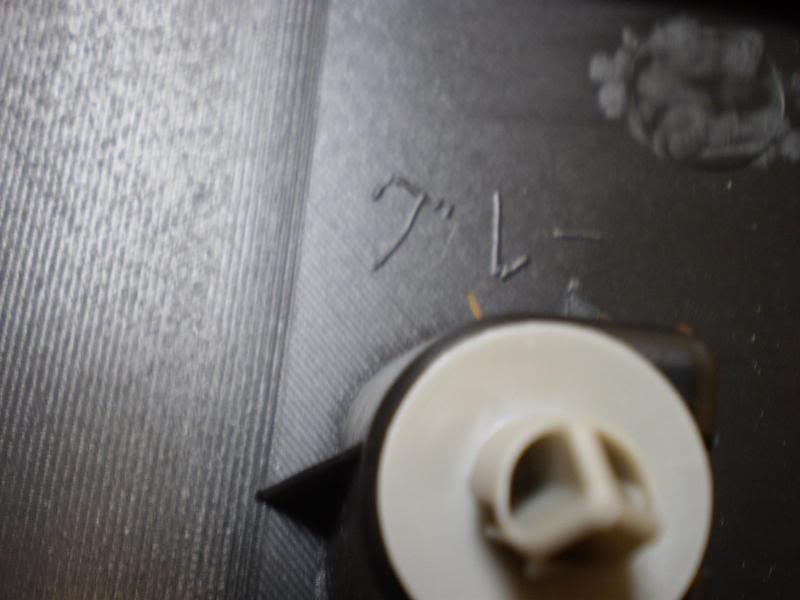

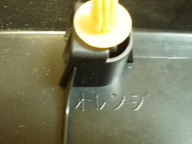

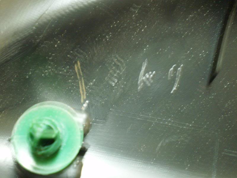

I guess i'll replace all the clips first and see what happens. Maybe mine are worn out?? I clipped them back on the hatch couple of times, but it seems like few of the clips, pops in when i push in, but pops out when i let go.
oh and btw, i noticed on the plastic cover. That they're 3 different color clips to hold it into place. 2 orange, 8 gray, and 1 dark green clip. By each clip, there's a writing in Japanese engraved next to it. So you can't confuse which color goes where.....How nice of honda. =]
