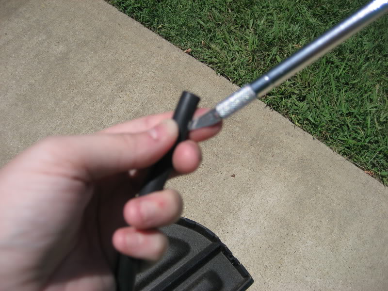

Then I cut a slit in it like so

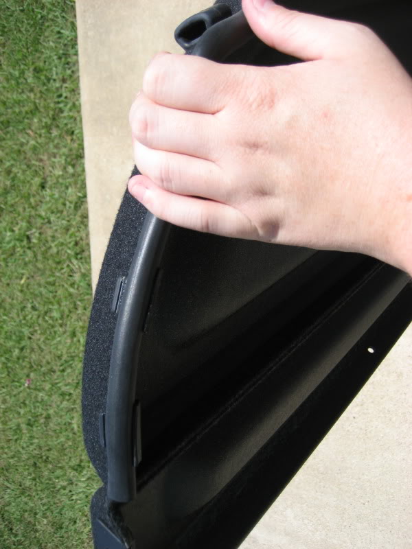

I then threaded the tubing onto the "edge" of the hatch cover to create like a rubber bumper that would reduce movement and noise.
At first I threaded the tubing the ENTIRE length of the cover but then realized that it was getting caught in the back corners and wouldn't fall down all the way with the hatch closed. I then modified it so that the edges near the seat were covered as well as the back edge...but the sides near the pillar ledges I left alone because a) there are rubber stoppers there already and b) the cover was getting caught with the tubing installed there.

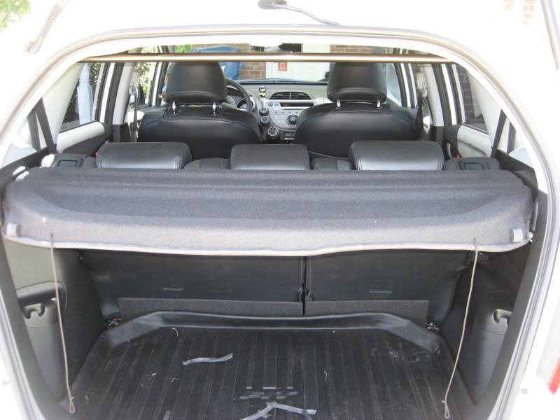

Here's the final product
Here's the "hatch ledge" that was causing most of the noise
And as you can see where I placed the tubing, it will lay right on that hatch ledge.
And NO noise is coming from that cover anymore! This was something simple and easy but had been driving me crazy. There are tons of bumps on the road from home to work due to poor planning of pipe projects by the city. And I would cringe hearing it every morning...now, I don't have to!
I hope this helps someone...although, you may not be rattle/noise sticklers like I am.

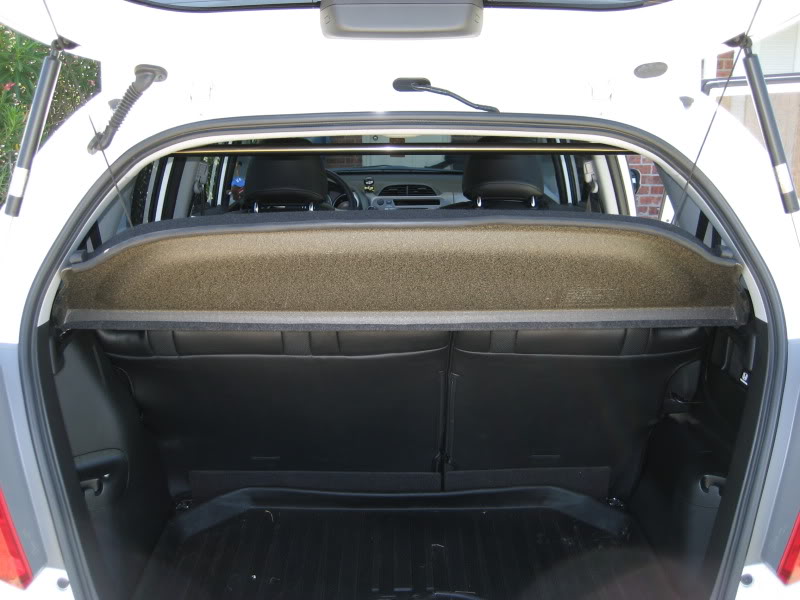

Here's how I had it BEFORE I had to trim. I just trimmed where those bumpers were and around the corner in order to get it to sit flush with the hatch closed
