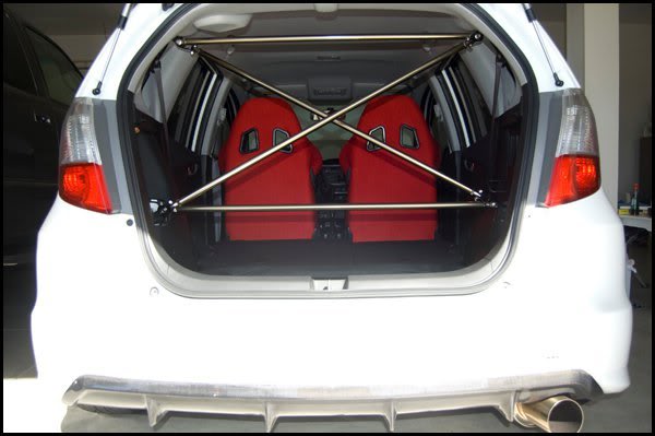

Originally Posted by fitisbamf
lol looks pretty legit

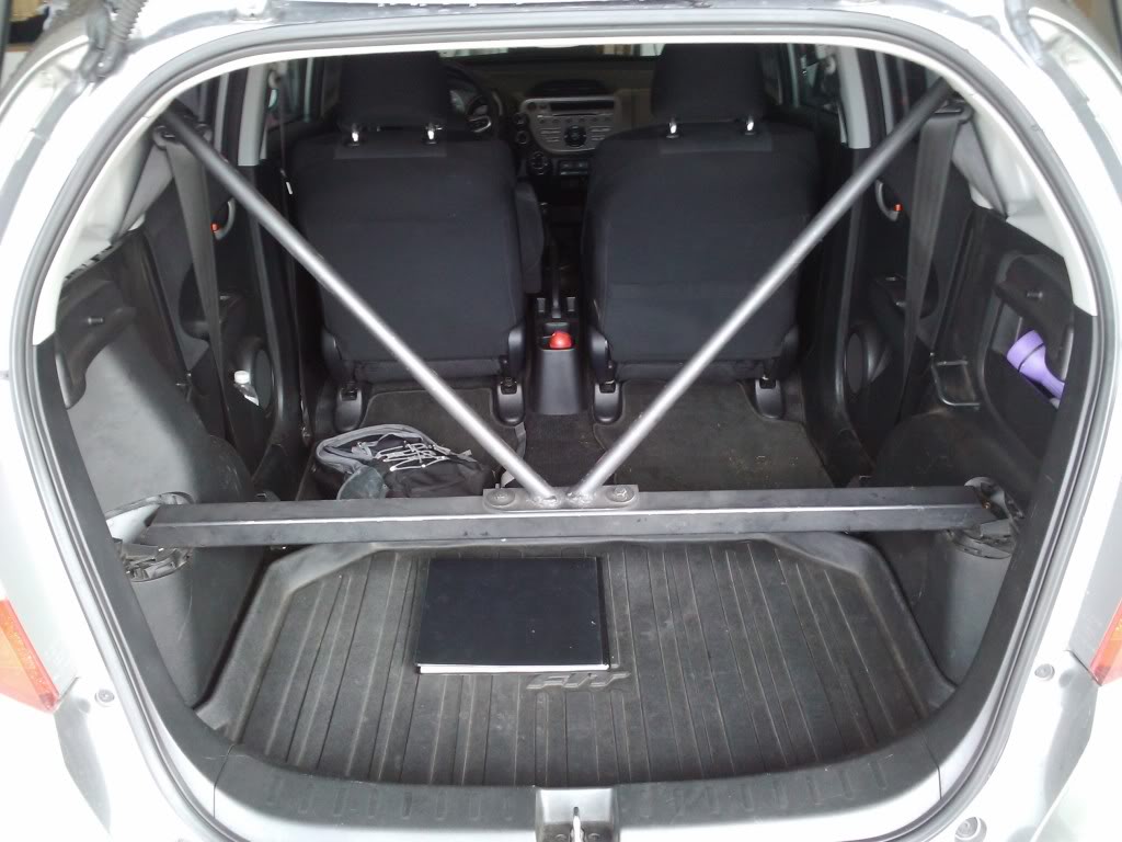

the original bolts will strip in time and I recommend you replace them asap there pretty lose I ended up getting some nice high grade bolts nuts and spacers from home depot for $9 it pretty much solved every problem with the noise and made it really rigid and yes you will notice a difference on the track and spirited driving.
here is mine
