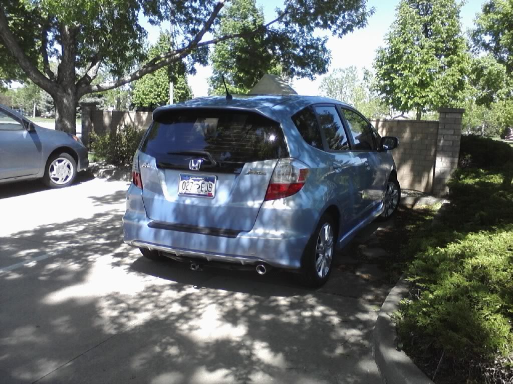

Uhaul installed mine and it looks the same as yours. I did have to take the ugly uhaul sticker off
