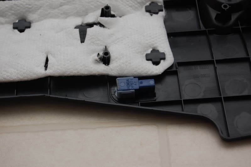

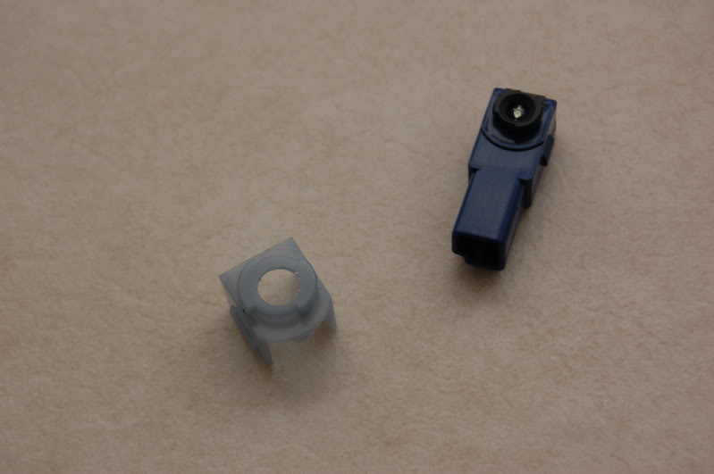

So, here is a very easy mod to increase the amount of light that the kit emits. Assuming you already have a drill since you installed the kit yourself, all you need to do is drill a hole right through the clear blue shims that attach to the ambient lights on both driver and passenger sides. The shims are removable and have two clips on both sides. Just carefully pry it off with your finger nails:

As you can see above, the shim is removed from the ambient light... Hole is already drilled through. The largest drill bit I used was a 5/16", working my way up from smaller drill bits.

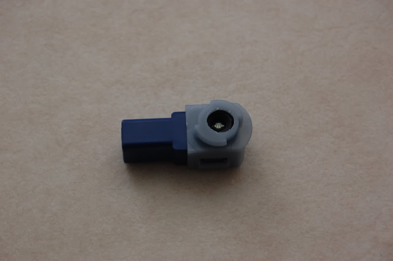

In the above pic the shim is put back on the light.

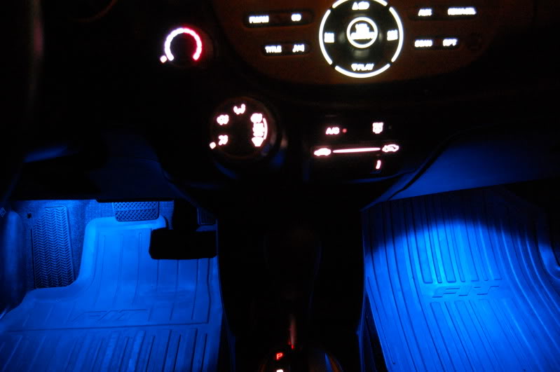

Now for the best part:
Unfortunately I don't have any pics before I drilled holes to compare it to this mod. But let me assure you, there is a very noticeable increase in light compared to stock installation.
Let me know what you guys think. Any questions, I'll be glad to answer.

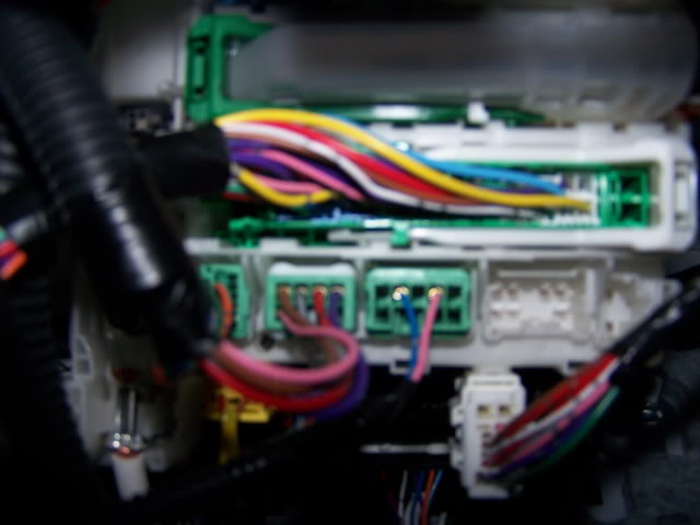

Is there access to the dome light circuit from under the dash? I like the idea of "courtesy lights" that come on with the dome. Should be an easy hack to take the Honda "Ambient" lighting and make it do this with the dash switch wired to turn them on, on-demand. If there is access under the dash to the dome light circuit...

Yes there is access at the fuse box. My lights work same as the dome. It is the two wires in middle green plug by themselves. The pink and blue ones.
There is a thread some were about hooking them up but sorry I cannot find it right now.
You do not need the Honda ambient to alter unless you want the dash switch.
