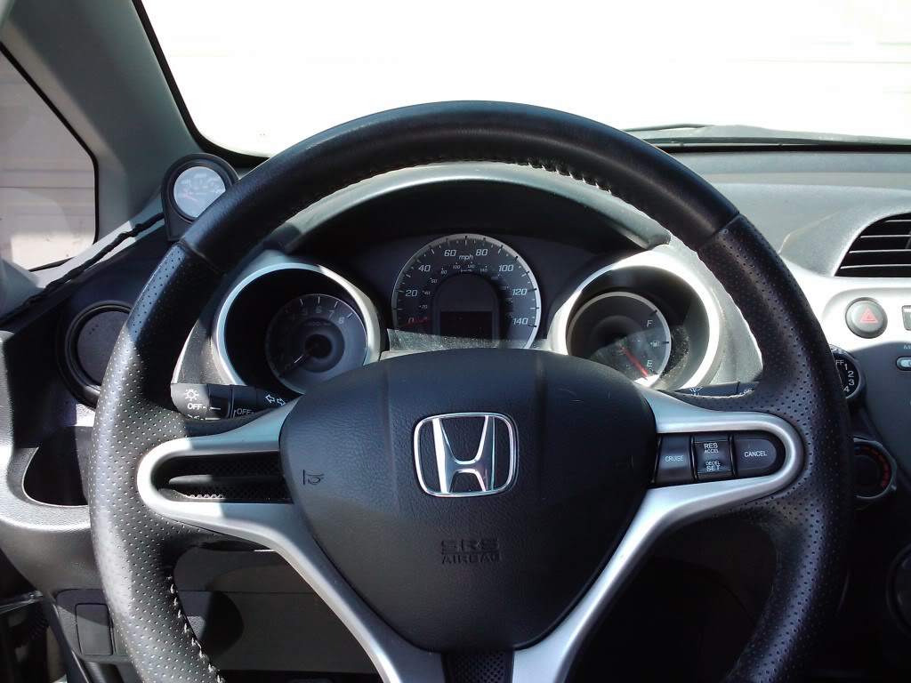

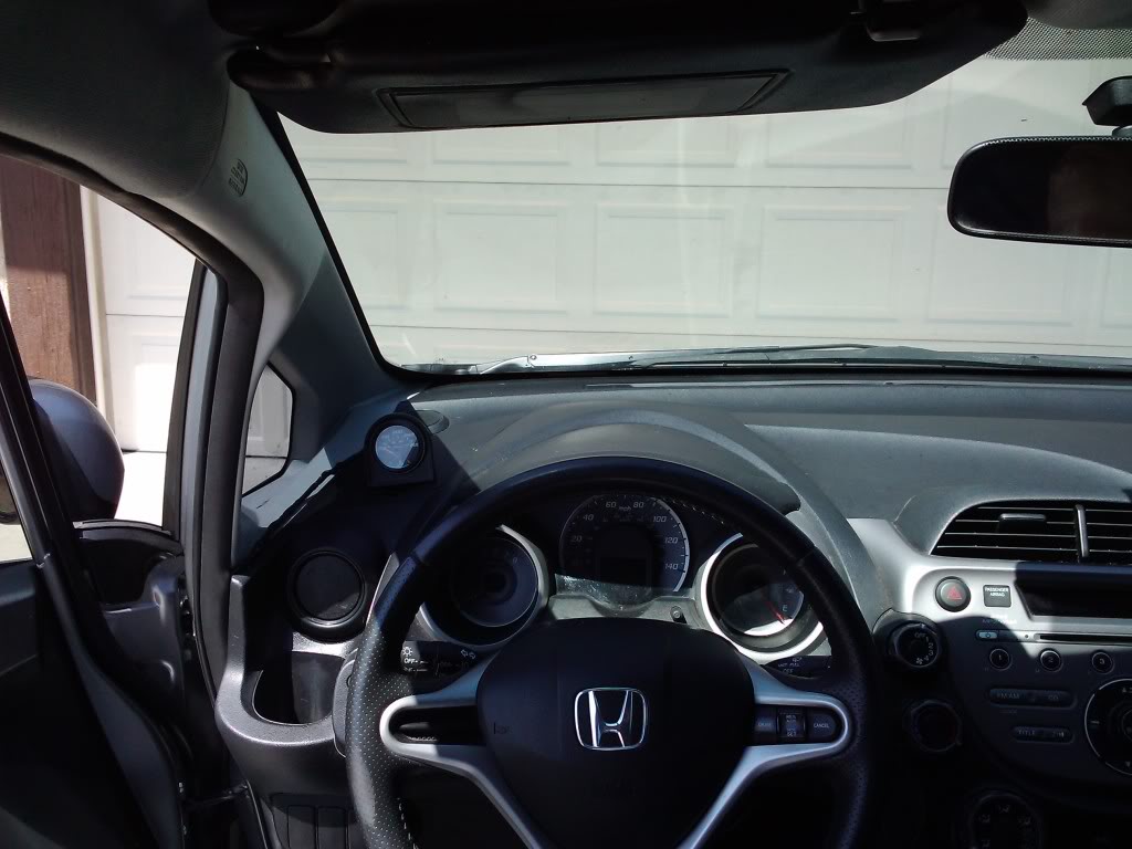

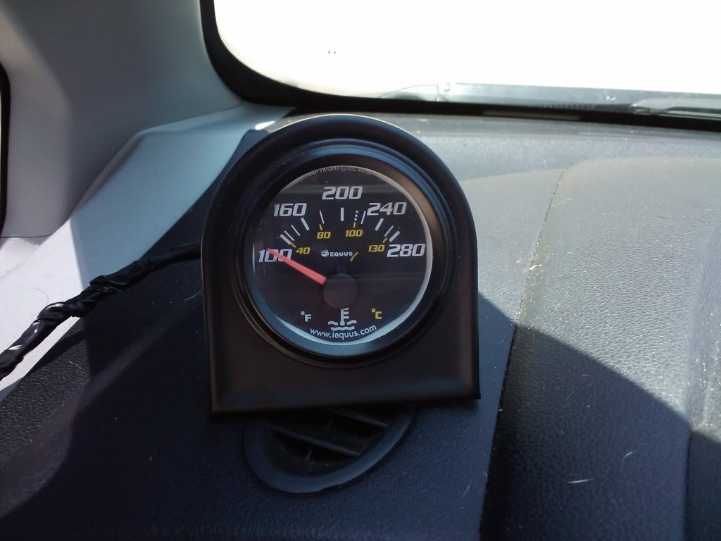

fitisbamf's Avatar
Joined: Jun 2009
Posts: 718
From: san diego, ca
i plan on routing the wiring thru the vent so its no all ugly but its f*cking nice to have water temp in this car

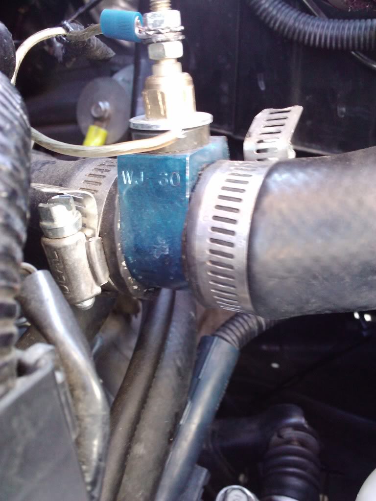

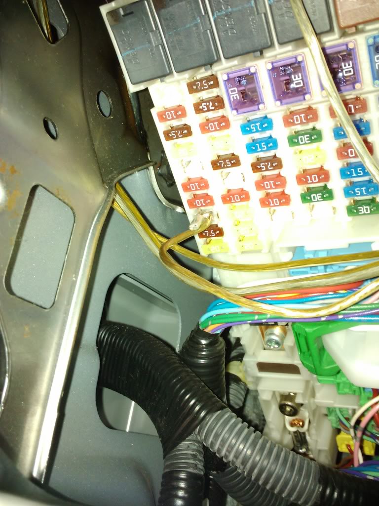

How did you wire up your water temp gauge?
Old Aug 1, 2011 | 09:49 PM
fitisbamf's Avatar
Joined: Jun 2009
Posts: 718
From: san diego, ca
ok so the gauge has 3 plugs on the back not including the lights, 1 is a power, 1 is the gauges ground, 1 is power to temp sensor, i noticed that the #7 fuse inside the cabin turns on only when the keys are on. with that i plugged the gauges power there, grounded it to some metal inside the cab. the last wire runs to the temp sensor, i used a coat hanger tapped to the wire, and poked it thru a rubber gromet in the firewall. the sensor unit needs to be grounded so i grounded that to the negitive on the battery. for the gauge light, (i took the easy route and since i found a power when the keys are on) so i plugged the light to the + and negitive i already had wired. look!
