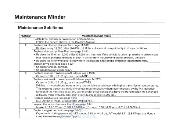

Our MT does require fluid changes. It is #3 on the Maintenance Minder. When you see that number, I'm guessing around 80,000 miles, it is calling for fluid change of the MT

Again, there is some misinformation floating around here. As GAFit pointed out, the transmission fluid, whether ATF or MTF, is to be changed on the Fit and is a sub code "3" on the MM system. The coolant is also suppose to be changed out and is noted as sub code "5"

Originally Posted by RevToTheRedline
I don't see anything with Code #3 that says manual transmission, it says in brackets (A/T Only)
"If you tow a Fit behind a motorhome, the transmission fluid must be changed every 2 years or 30,000miles (48,000 km), whichever comes first. (A/T only)" only applies to A/T's! But both require fluid changes when sub code 3 pops up...
Old Jan 17, 2012 | 01:39 PM
  #54
GAFIT's Avatar
Posts: 4,329
From: Cleveland, GA
mhadden, my service manual is different from yours. It breaks out MT and AT under #3 and says the type and quantity of fluid to use. Just like yours the towing behind motorhome is only for the AT.
My service manual is in .pdf. Is there a way to post pages from it without printing and scanning? I do not have Adobe editor.
I got ya' covered. <08' Honda Fit MM codes:
(I have Adobe Pro 9, so I open the pdf and export to jpeg. Then use imageshack to host.)

Old Jan 17, 2012 | 02:10 PM
  #57
GAFIT's Avatar
Posts: 4,329
From: Cleveland, GA
Old Jan 17, 2012 | 02:12 PM
  #58
GAFIT's Avatar
Posts: 4,329
From: Cleveland, GA
That's three different versions of the Service Manual and ALL say the same thing. You HAVE to change the manual transmission fluid. This is normal and recommended regardless of make/model.

Originally Posted by Vash
ahh yeah sorry for the confusion, yeah you have to change your fluids, just not the transmission fluids.
I think if Honda didn't want us to replace the MT fluid... they would say (on page 251 of the 2010 owner's manual):
3 ● Replace transmission fluid (For A/T only)
Driving in mountainous areas at very low vehicle
speeds results in higher transmission temperatures.
This requires transmission fluid changes more
frequently than recommended by the maintenance
minder. If you regularly drive your vehicle under these
conditions, have the transmission fluid changed at
60,000 miles (100,000 km), then every 30,000 miles
(48,000 km). (For A/T only)
fluid must be changed every 2 years or 30,000 miles
(48,000 km), whichever comes first. (For A/T only)
But that's not the case, instead it looks like:
in fact, if you look at the two other instances of "(for A/T only)," it implies that the "A/T only" only applies to those sections it is actually listed after.
On that same page, on the left side (for the A and B code)... one of the listed items under "Inspect these items:" is "All fluid levels and condition of fluids".
B ● Replace engine oil and oil filter
● Inspect front and rear brakes
● Check parking brake adjustment
● Inspect these items:
● Tie rod ends, steering gear box, and boots
● Suspension components
● Driveshaft boots
● Brake hoses and lines (including ABS/VSA)
● All fluid levels and condition of fluids
● Exhaust system#
● Fuel lines and connections#
● Check expiration date for TRK bottleꭧ2
MTF is still a petroleum based lube... and just like motor oil, it is subject to contamination.
