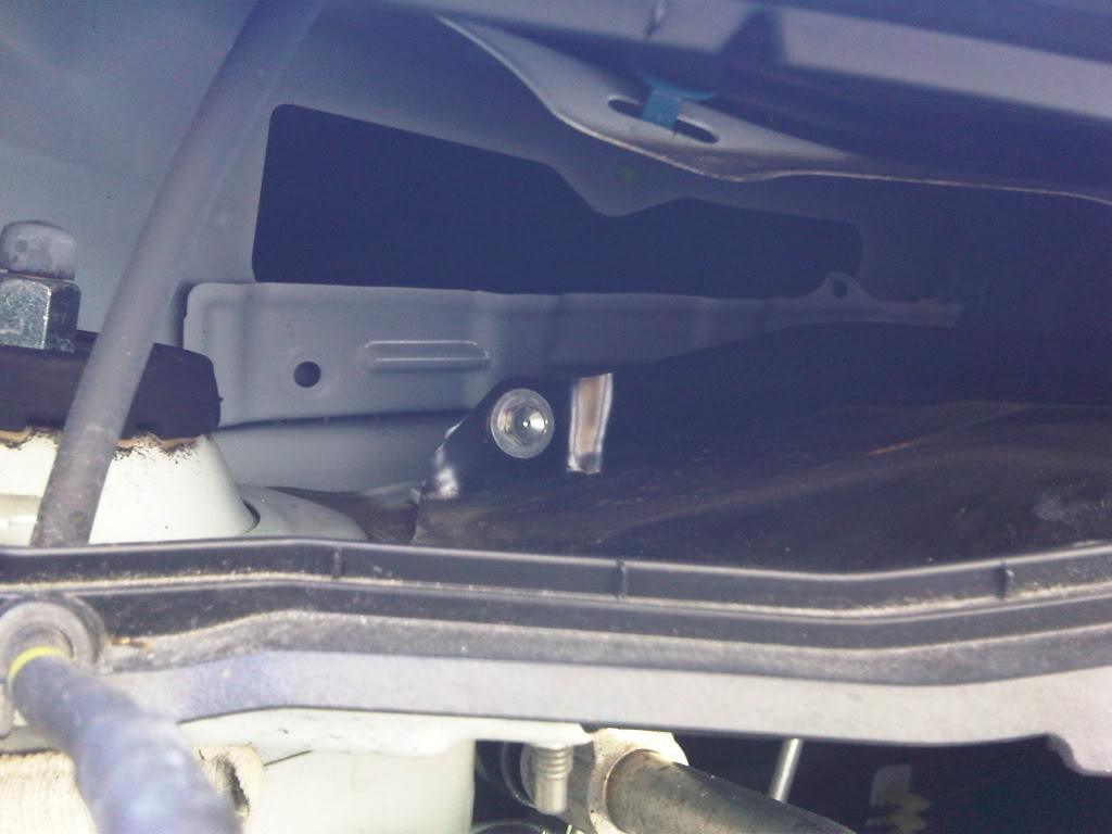

Subie, do you know where is the exact location outside air intake for the ac?
Looked for it a number of times and haven't found it.
I'm about to remove my cowl to look deeper.

What I mean is, where does the ac intake pull the air from when set to "fresh air" mode?
For example, we know the exact spot where engines pull in air. Where does the ac pull the air from?
We know that there are cutout openings in the cowl (near wipers), but where is the opening to allow air into the cabin?
I've had my first GE8 since 2008 and still haven't found it. Lol.

The outside air intake on my 2012 MY Fit is at the passenger side end of the cowl directly behind the passenger side strut tower. If you examine the vertical wall of the black plastic cowl just below the rubber hood weather strip you will see a slot for prying off an access panel. The panel is about six inches wide and provides access to the strut tower. With it removed, you can see where outside air goes down into the fan.
So, basically, indeed to remove the cowl?

If you pry open the access cover that I mention you can get a good look at where the air comes in. I don't think there is any good reason to remove the entire plastic cowl. You probably remove the air intake fan from inside the vehicle behind the glove box.
Found it. Perfect advice.
