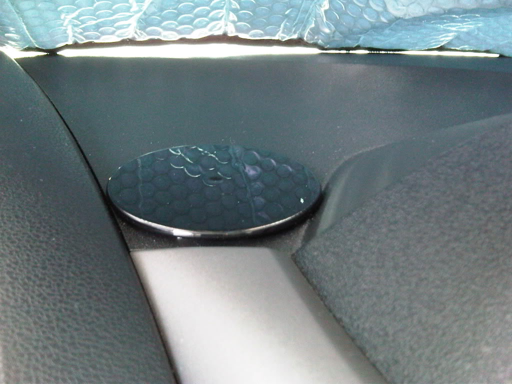

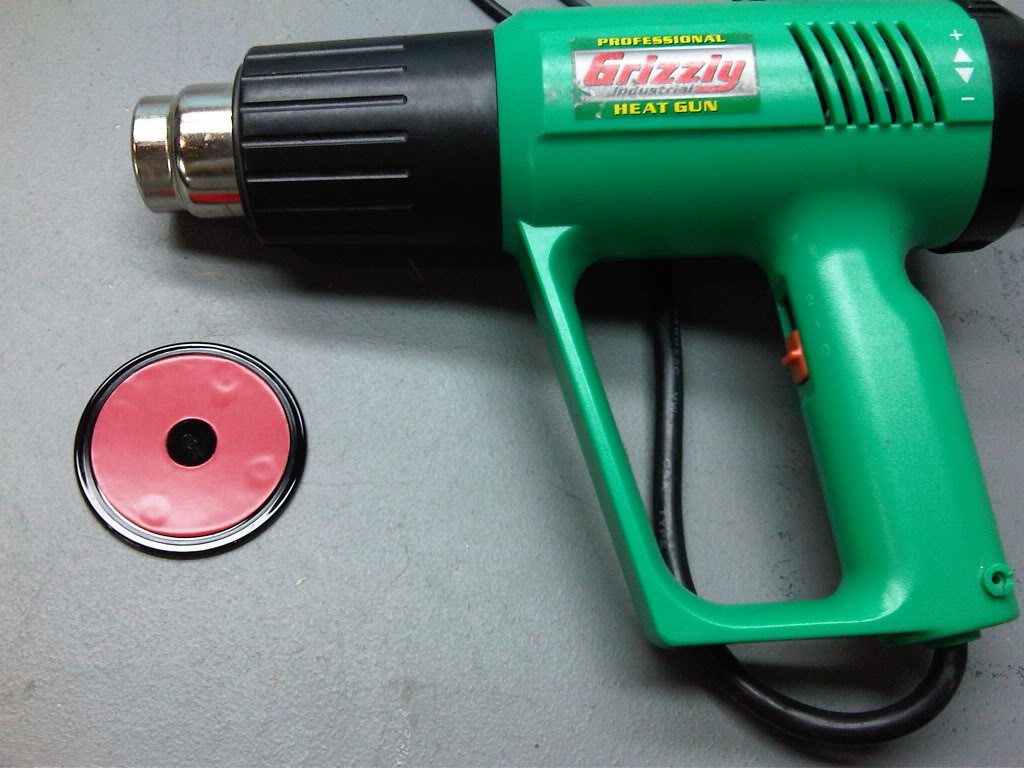

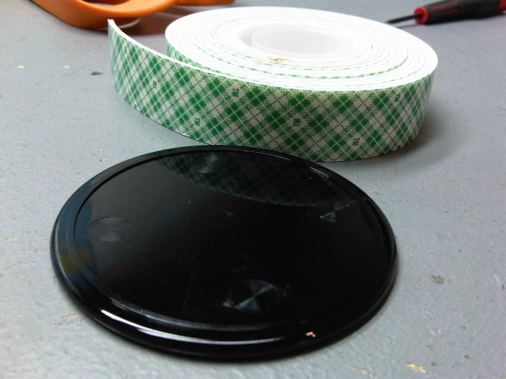

Have you attempted installing the mounting disk with double sided tape?
I removed the original tape with a heat gun and installed double sided tape from home depot.
It holds a Garmin with a 5 inch screen so it's pretty strong and I'm sure will handle a cell phone.
Also, no marks or damage when removing. Just heat the tape up and it will come right off.
I have this set up on both my Fits without issue. If you live in a cold climate where it may harden the tape, you may need to replace it once a year or so. I'm in S. FL so I don't have that issue.
It's very simple to do and much better than drilling a dash even if you do plan to keep it.
Original Tape:
Tape Removed:
Installed:

Great idea Shora! I'd try that idea.

Pretty much as you have shown, I used 3M molding double sided tape originally. That failed after a bit so I was looking for a permanant solution. Last night it occured to me that maybe the residue from using Goo Gone to clean the dash was causing the tape to come loose. I cleaned it twice with alcohol and have re-installed it last night. As of this evening it was holding in place. I'll update this once some warm weather hits. I think the other culprit may be expansion / contraction of the plastic dash when the temperature goes above 80 degrees. Time will tell...
