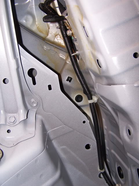

On the right hand side you need to pull the panel off and pull the two clips holding wiring to the body out. Then you have enough slack. Well for the old style ones I put in.

I actually only removed the access panel to the passenger side tail light. Then I removed the first clip inside the body...not the one at the very bottom. That is not needed. I actually cut the wire loom that held all three pigtails, I cut it about an inch. This gave me enough slack to work with the brake light pigtail. Once everything was installed, I wrapped electrical tape around the wire loom again and you cant tell I ever cut it to get more slack. It looks stock again. It definitely was a bitch compared to the drivers side. Also the bulb sockets are completely different from the JDM tail to the USDM tails. If anyone has any problem in the future, you can PM me and I will get back to you. I am on everyday, so I should get back to you shortly.

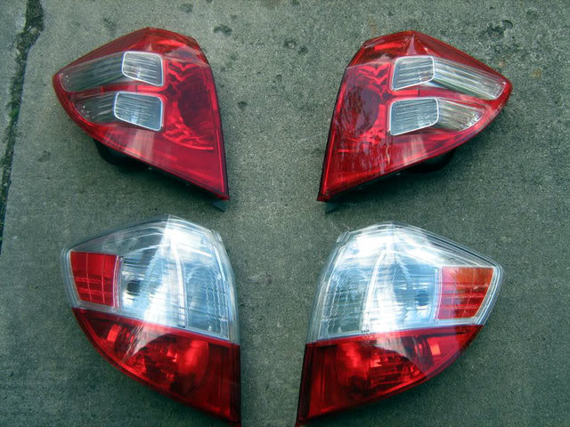

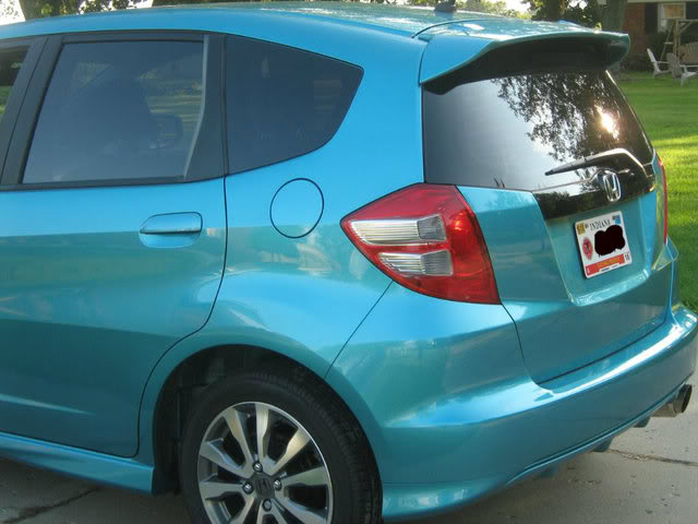

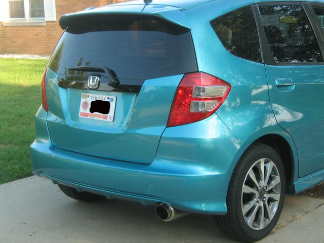

I actually got mine off of the classifieds on here. The seller said they were in mint condition and they pretty much were. Only a few minor swirls and surface scratches. I do body work and paint so I took some 3M 3000 grit sand paper I had laying around and wet sanded them. Then I buffed and polished them. They look absolutely brand new. You can pick up a 3M headlight restoration kit at your local parts store for around $20 I believe. I just used my materials that I use on paint jobs. I just saw a pair of non Led like mine on the classifieds yesterday for $140 shippd and they looked pretty nice. Here is what mine look like now...
