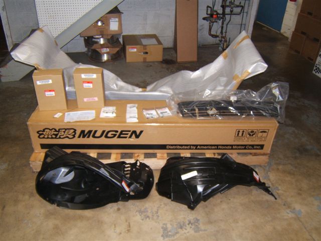

Alright so heres the process:
First there was the Prep.
Since I live in canada, I had to ship my parts from college hills honda because its WAY cheaper even with shipping.
Exact parts can be found on the forums
Waiting for these parts felt like forever. drove me nuts!

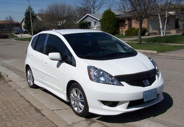

Pics of changes well done Connor.

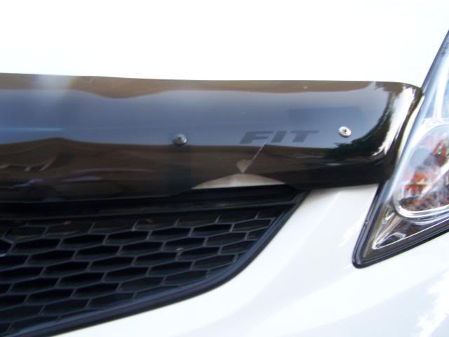

My hood deflector saved my hood.
Here is the hole but the hood was not damaged. Cheaper to replace the deflector than having a repaint.

Ouch. Glad your hood is okay.
