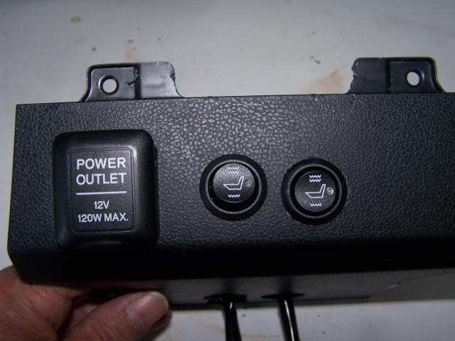

The existing outlet is 20 amp and should handle what you want. I have my heated seats on this circuit, GOS and my grill mounted LEDs

Installed. Steve244 there were other similar holding other corners of the blower housing closer to the center of the dash that worked like a charm and easier to get to... thanks for the tip. Black3sr didn't realize it was 20amps but I still had to mess with routing wires anyway so the add-a-fuse out fine. I can't believe you're tapping into those skinny wires at the cig lighter to heat seats!
