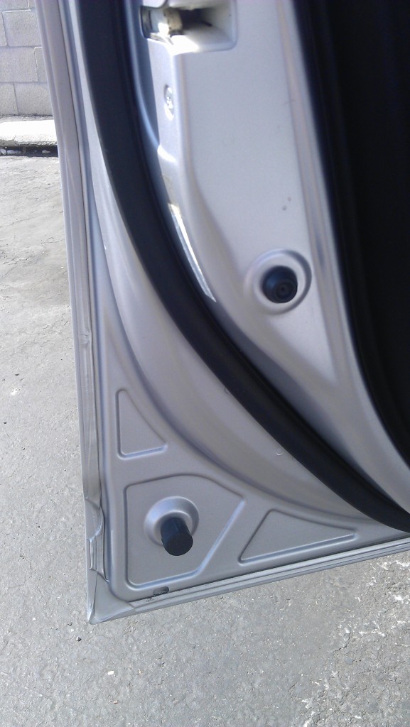

Size:  136.7 KB ahh i found these on my door hmm ima ajust them all around and see what happens mabey they moved cuz i wipe my door stills real good no dust I hope it works : / can knw till after work : / ill keep yall posted

try putting some silicone spray (not wd40) on the rubber bits and seal around the door. Put some on the spring and strut bushings/pads.

thanks steve first ima ajust the bushings then if not ill get the spray u posted thank aslo sounds only coming from my doors

UPDATE so i adjusted the bushing on all the doors my creeking is gone weeeeeeeeeeeeeeeeeeeeeeeeeeeeeeeeeeee
