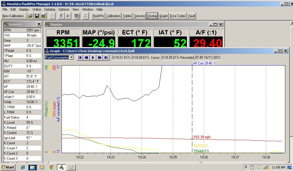

Originally Posted by komafit
I've read many newer cars do this, but if you try it on the Fit while watching the Ultragauge you'll see that coasting in neutral, at least on the MT, the fuel consumption is far lower. It's easily observable.
Not sure how much more plain I can make this.. If the engine is idling because you are in neutral, fuel is being consumed to avoid stall. Therefore consumption is higher coasting in neutral, end of discussion.
If the injectors are off, you are not using fuel.
Rolling off the gas @ 40mph in gear:
Fuel scheme is showing a stoich burn @ 14.2:1 AFR.
Completely off the gas shortly after.. injectors off and the O2 sensor is pegged lean:
ECU indicates max lean, or 29.4:1 AFR but in reality its approaching infinity as there is no fuel but the sensor doesn't read that lean.
Duty line in yellow is Injector Duty Cycle, 0% = Injectors are off.
It's easily observable that you don't know how EFI systems work.
