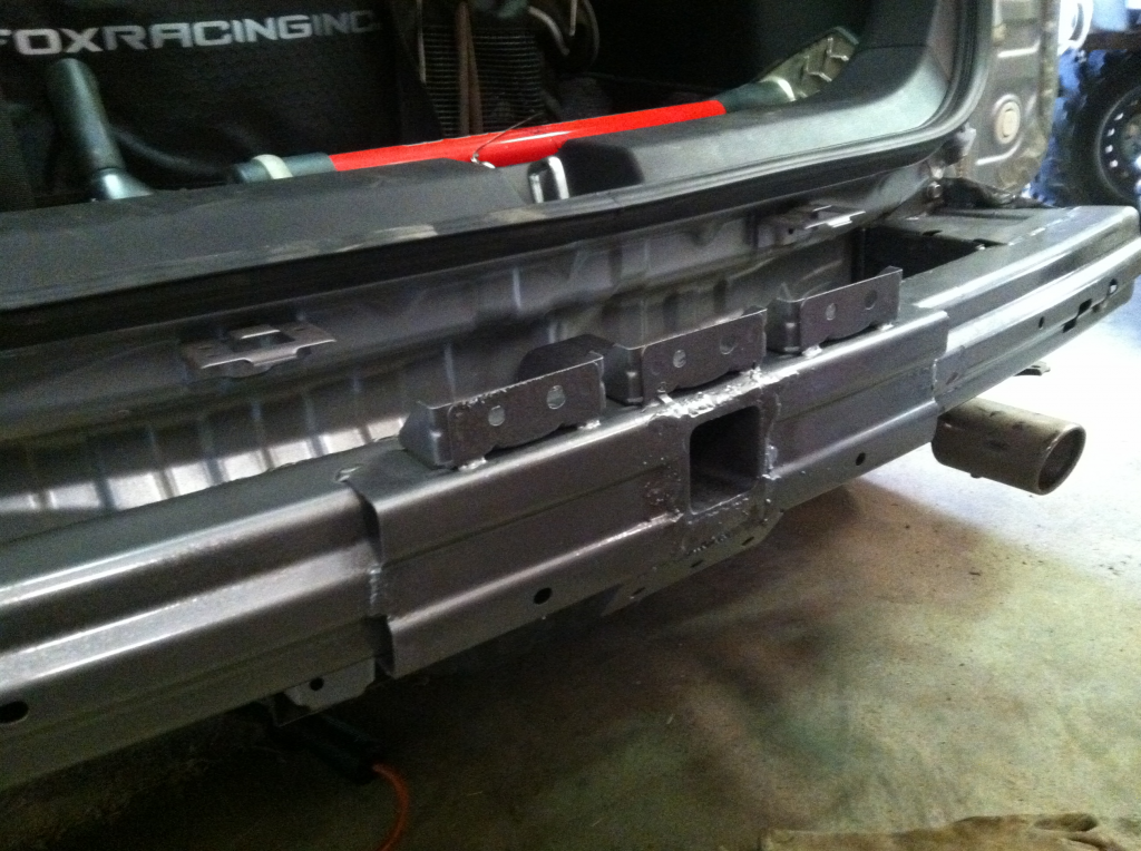

I made a custom 2" receiver hitch to haul my motorcycles and for my bike rack. To answer your question, yes, they do make adapters to go from 1 1/4" to 2". You can get one online or even from Harbor Freight. The aftermarket hitch from Curt Manufacturing appears to be the strongest of the ones available. I did not use an aftermarket hitch because of how low they hang down and I frequently drive over very steep driveways and rutted dirt roads.

I'm not sure if the aftermarket hitch will adequately support a 200 lb mobility chair as it hangs out pretty far. Just so you know, adding a hitch may void your Honda warranty
