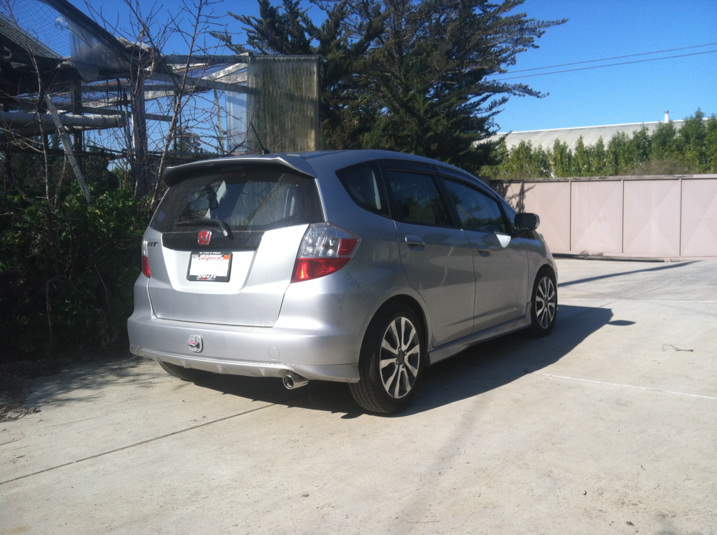

Swift springs + Coca-Cola receiver hitch cover
Lowered Fit 1 1/2" front and 1" rear. Why the Coca-Cola bottle opener? Because I had one laying around the shop.

i was stock
omg love the rear H got pic of the front im ur twin lol
