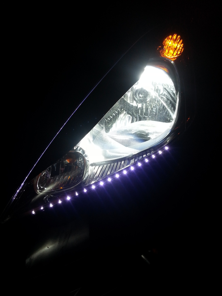

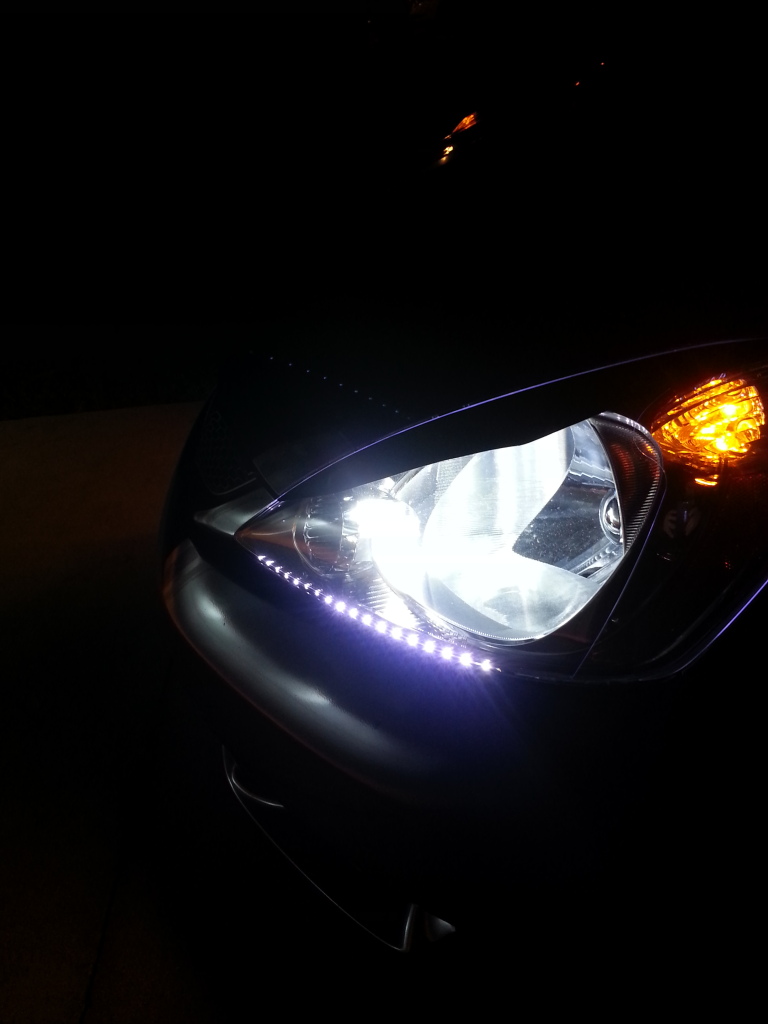

These pictures are actualy great examples as to why you DON'T want to put HID's in a halogen headlight. Lest look at the first photo. You see all that light above the cut off? Yea that is BAD, that is glare and that is what is blinding on coming traffic. You want to know what it looks like when you do a proper retrofit? Well take a look at this picture I took back in 09 when I had a retrofit.
Would you look at how clean and crisp that cut off is, it just looks so amazing. Now the second pic above is another great one because you can see just how much glare there is when off to the side of the car. Could you imagine that car being right next to you at night? its headlights would be blinding you when there are next to you! how annoying is that, its very I tell you what.
Ok. I took some better quality pictures to show it's really not all that bad.

Like others have said, not nice. The glare is awful for both oncoming drivers and for yourself in areas with little/no ambient light... aka outside of the city (especially if you have light sensitive eyes)
Originally Posted by GenzoX
Yea I see what you're saying.... However. ... I like being that asshole xD plus I can see all the road signs in front of me. I have yet to had a person flash their lights at me. I'd rather have people see me coming.
HID's aren't going to make people see you coming more than any other headlight and they'll be detrimental. HID's reflect more light off of things that shouldn't be illuminated (or illuminated as brightly) such as bushes off to the side, trees above, signs(shouldn't be as bright as they are). While all of this sounds good, it is actually very bad for night vision. the more useless light reflected back at you, the more your pupils constrict... and in turn, the less you actually see.
For Example, Try this:
In the dark, go outside on the porch and shine a light towards the woods, then hold up a few pieces of white paper reflecting back some of the light. (or simply turn on the porch light) In which instances do you actually see more? definitely not the papers in front of you or the porch light on, which is what HIDs illuminating everything around you is essentially doing.
The goal is VISION, not total lumen output and the two are definitely not directly related. You want as much light as possible but only exactly where it should be and NOWHERE else. any light where it shouldn't be negates some of the "well aimed light". This is the Real benefit to Projectors: Focused light.
Morimoto seems to have been a great success for many looking to retrofit and produces a much better cutoff than the above example.
