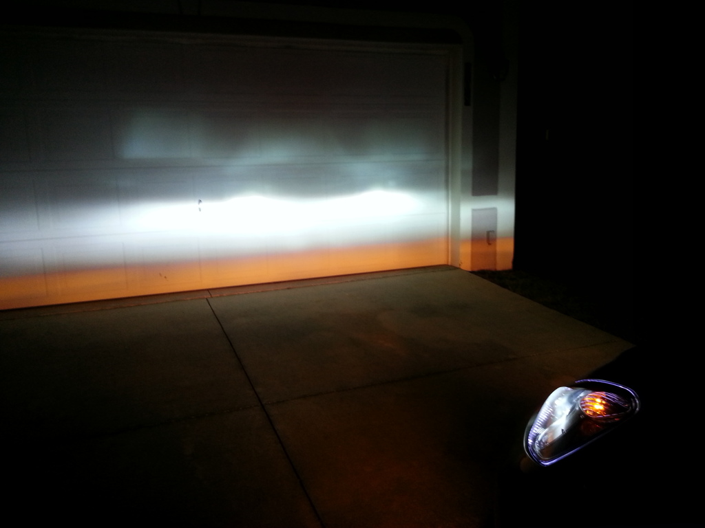

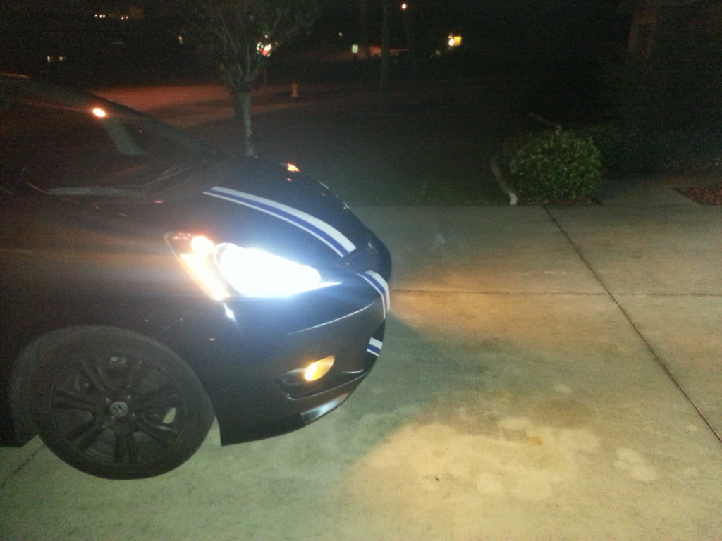

Here's mine.

Originally Posted by GenzoX
Here's mine.
That's a horrible cutoff line.
Please do it right and retrofit. As mentioned before reflector headlights are not good for HID kits. I've used Silverstars on my Integra and Evo, the bulbs are brighter than stock and whiter color also.
Old Feb 23, 2013 | 01:12 PM
MNfit's Avatar
Posts: 3,380
Here's mine.
These pictures are actualy great examples as to why you DON'T want to put HID's in a halogen headlight. Lest look at the first photo. You see all that light above the cut off? Yea that is BAD, that is glare and that is what is blinding on coming traffic. You want to know what it looks like when you do a proper retrofit? Well take a look at this picture I took back in 09 when I had a retrofit.
Would you look at how clean and crisp that cut off is, it just looks so amazing. Now the second pic above is another great one because you can see just how much glare there is when off to the side of the car. Could you imagine that car being right next to you at night? its headlights would be blinding you when there are next to you! how annoying is that, its very I tell you what.
