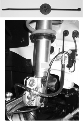

See... Even if you only track or AutoX occasionally, being able to soften the front, then stiffen up the rear suspension, THEN once your done go back to a preffered "street" comfort setting... Can ONLY be done with adjustable dampers...
Also, the Bilstens come with zip ties to secure the ABS sensor.... Frankly, I think that is BS. ESPECIALLY considering the price! How hard is is it to weld a bracket to the shock body to clip the sensor back into?!
The Redshift photo shows brackets:
WAT?
Now I don't feel bad about using zip ties to hold my brake lines in the past that's just half-assed for a manufacturer, especially one like Bilsten.

WAT?
I mean, it's a "fancy" zip tie with a plastic nutsert thing half way down it that you screw onto a threaded post.... but it's STILL a zip tie...
See... Even if you only track or AutoX occasionally, being able to soften the front, then stiffen up the rear suspension, THEN once your done go back to a preffered "street" comfort setting... Can ONLY be done with adjustable dampers.........
I agree 100%... and that's a GREAT "pro".
WAT?
Yup
top of page 6 of their install pdf shows the ziptie bracket clearly... http://cart.bilsteinus.com/pdfs/E4-WM4-Y626A00.pdf
Their R&D is great, but that ziptie....

For those who don't want to look throught the PDF, Boom:
http://qkme.me/3u2wmx
The Zip Tie will enable Bilstein to use it on many different car with several different mounting type for the brake line.
I mean they are a mass manufacturer,
and our Bilstein model is a cheaper version of Bilstein anyway.
The cost save by Bilstein by doing this method over the entire offering
will be substantial compare to welding a custom bracket for every single car.
Of course the welding of the mounting bracket for the suspension is a must, but if they can save cost for this brake line, they will.
