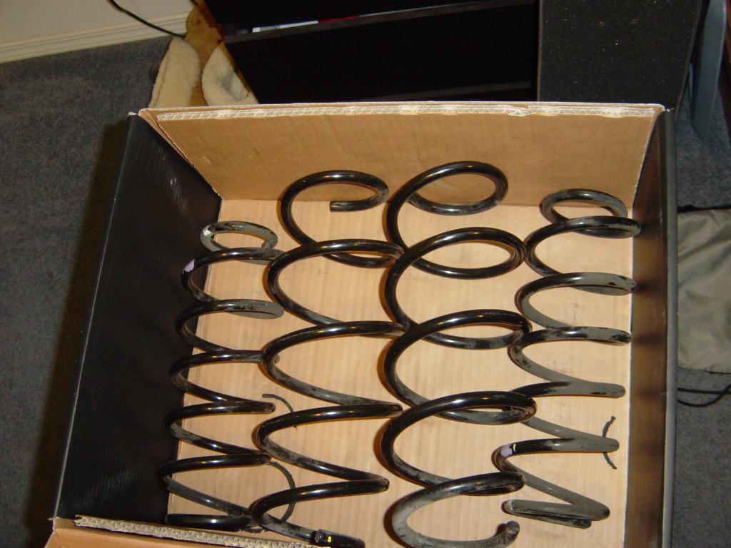

Yes, at first that puzzle me too,
why stock spring with linear and softer spring rate do NOT break?
but I think it is because
the stock spring is much taller (the way they wound the coil)
so it have more range of usable travel built in..
compare to the Koni's (or is it eibach or swift) linear spring...
again correct me if I am wrong...
The first time I know that linear (non factory) spring need to have harder spring rate was from Chris on one of his post at this Koni's thread.
