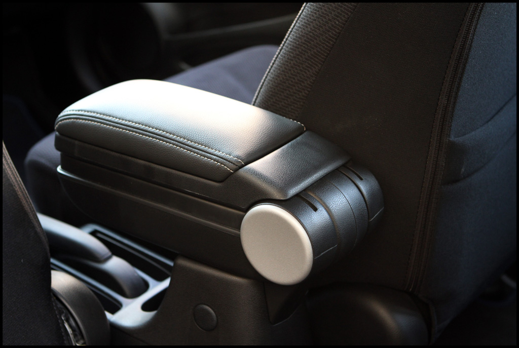

I just purchased a 2011 Honda Fit Sport last week and I want to add the OEM center armrest console.
The problem is that I'm not very handy when it comes to things like this so I called a couple dealers and the best price I was able to get was $92 for installation.
So my question is, how difficult would this really be to do myself?

Install is really easy, with the right tools it only took me like 45 mins tops taking my time & trying not to scratch up the interior.

It's pretty simple, only mildly scary having to drill the console plastic... but really you'd have to be really inept to screw it up. I actually did buy mine from here 2nd hand, but they don't come up very often.

Drilling isn't so bad at all. It's all marked out on templates under the console plastic.
The part that you need to be careful about is trying not to drop the side bolts under the carpet when installing the metal bracket.

As was said. The center console has marks where to drill. I used a step drill bit and it made the job much cleaner. That would be the only step that I would take your time on.

As they say in the TV jokes, "A child of six can do this". "Okay, bring me a child of six". Anybody can do it. Among your tools, have a telescopic magnet pick-up tool, because you will probably drop one or both bolts under the carpet. Otherwise, e a s y! Don't pay anyone else to do it for you.

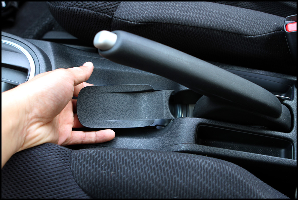

Pop out the factory Sport armrest with a screwdriver.

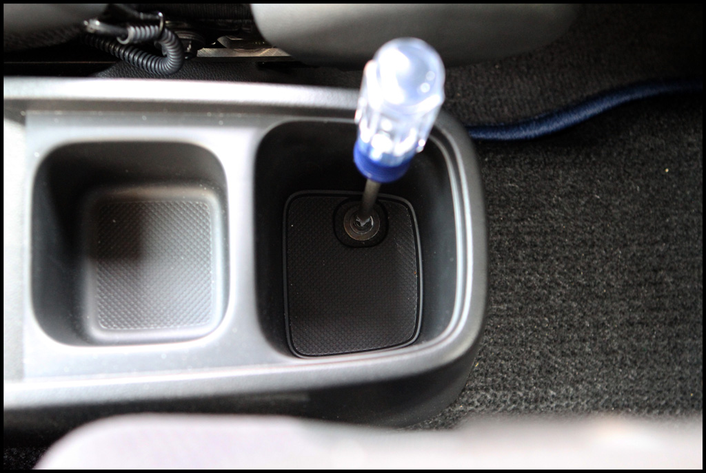

Remove the large 14mm bolt holding the armrest.

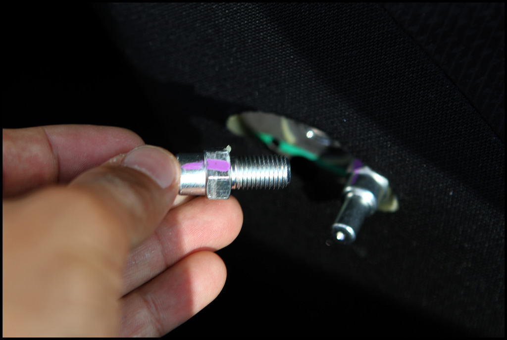

Remove the 12mm "studs" with a deep socket.

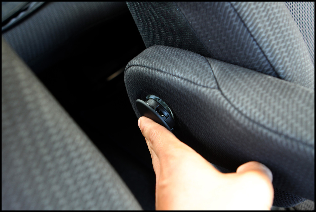

Install the supplied "cap". Initially it didn't fit snug, but I eventually got it to fit.

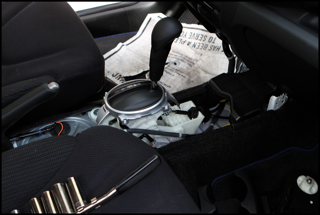

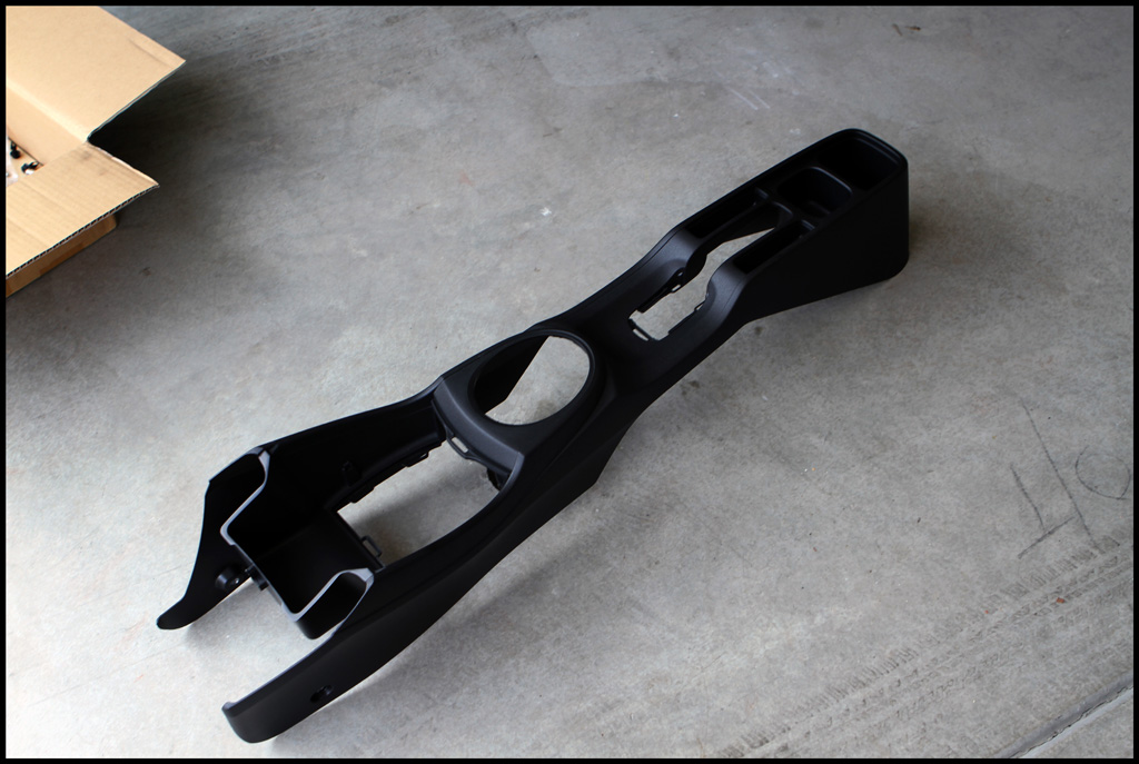

Next, remove the entire center console. A pain as usual.

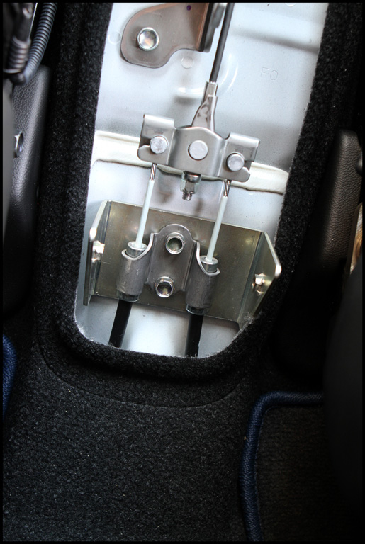

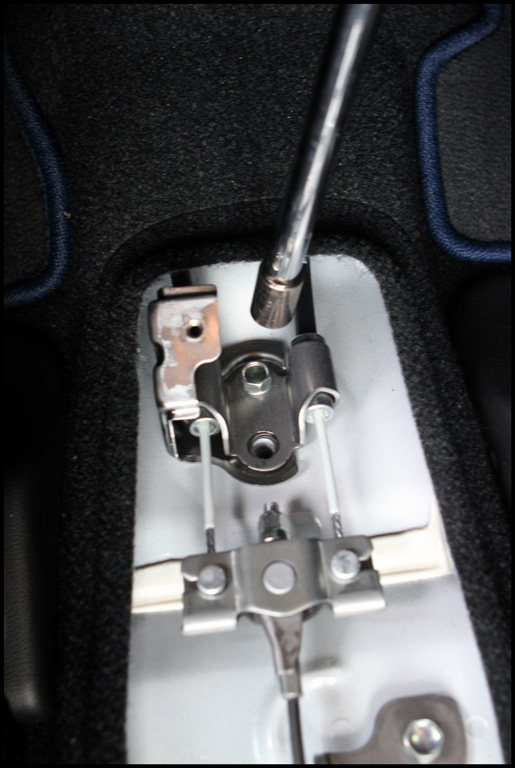

Unbolt the handbrake bracket thing.
Install the supplied bracket underneath. The instructions supplied by Honda are actually incorrect here. It's supposed to be flipped so the angled portion faces the other way. Of course I had to disassemble everything afterwards to fix it.

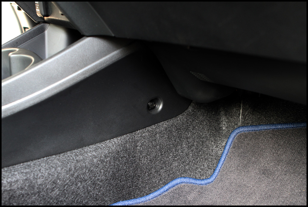

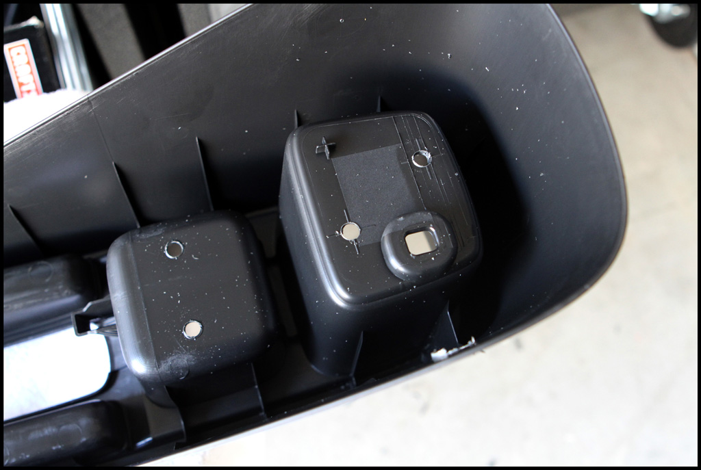

Now you have to drill a few holes. Luckily, Honda put in marks where you're supposed to drill.

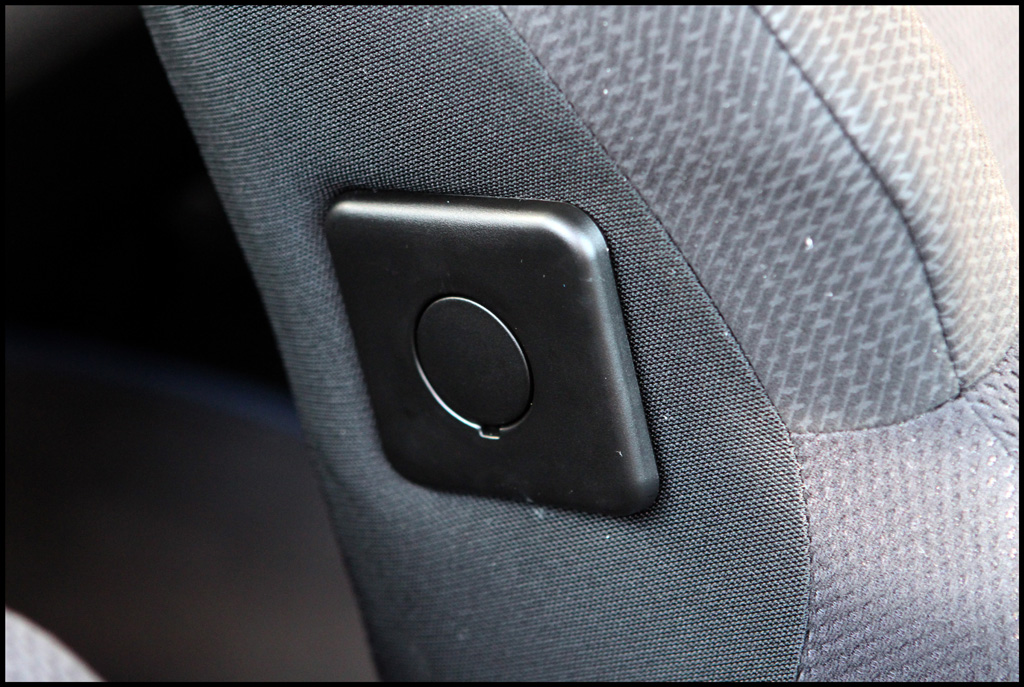

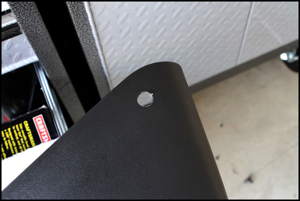

Now you're supposed to drill a larger hole here. Since the rubber caps are the only thing I didn't have (the seller kept them since he needed to cap his holes) I drilled the smallest holes possible.
