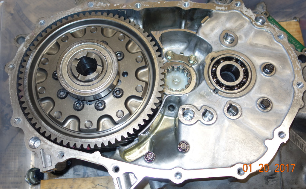

Spent another hour changing oil seals and bearings. The helical LSD sit perfectly in the transmission housing. Tomorrow night measure the shim then head for my local Honda dealership on Saturday morning. Saturday I can work on the gear stacks

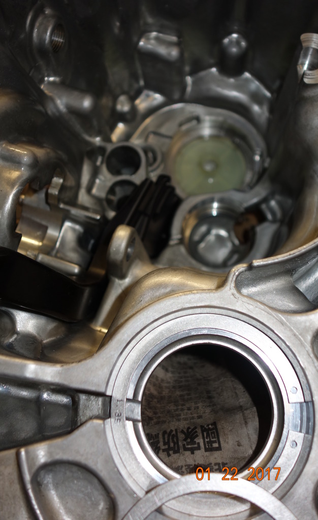

I measured the shim this morning and placed the order with my local Honda dealership for two shims, 1.30mm and 1.35 mm. Just in case I measured wrong. On the way home from the dealership I realized I should have check my spare tranny. I pulled the shim out from my spare tranny and surprise surprise surprise. It is 1.35 mm. One of the size that I ordered. Tonight I will be busy if my measurement are correct and the 1.35 mm is the right one.
